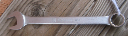

I think I still have a couple pre-Snap-on CAT wrenches with the old C logo (Proto?)
They were Williams, not proto. The current "supercombo" was preceded by the "superench" from 1960 to the 90's.
The angle/hydraulic wrenches have been always based on the snap on forgings but not polished
Hmmm...not sure this is correct. I’m going off memory, but I’m fairly certain Proto was involved at some point. Its been a long time since I researched it. Mine may not be, but IIRC some were.

Cat in the 80’s sold a premium line and a value line wrench ,Proto being the value line and Snap-on being the premium.
I have all these wrenches and believe the so called Snap-on wrenches were actually Blue point as they are all only stamped on one side of the wrench where a Snap-on is stamped both sides, the chrome is not as good either by comparing wrenches.
The early ones (8H wrenches) were a Par-x tool some with the Pac-Man symbol.
