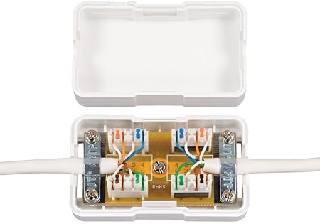

According to the specs you really can't splice CAT5, much less CAT6 & still maintain the rating. I'd avoid splicing if you can at all. If you do splice, just like you are suppose to when terminating things, keep the proper twists in the pairs right up until the termination or the splice. The proper way to do it is termintate the cable rather than splice.
That said I've spliced coax (ancient 10base2) into 1 pair of phone line to get between floors & gotten it to work at 10 megabit (back in the 90's in colledge) & Ethernet to my barn is running on 2 of the 3 pair of CAT3 (100 megabit tops). I've got the new conduit burried, but haven't pulled the new CAT5 out there yet.
Sent from my K00C using Tapatalk
Never heard of this. Its done all the time without issues.
And these are perfect for splicing cat6:
http://www.amazon.com/dp/B005M20QC8/?tag=atomicindus08-20

Zipties aren't allowed per the Standards either. Velcro straps are the preferred method.
And technically you can 'splice' CATx cabling per the Standards, that's essentially what a MUTOA or a consolidation point is...
