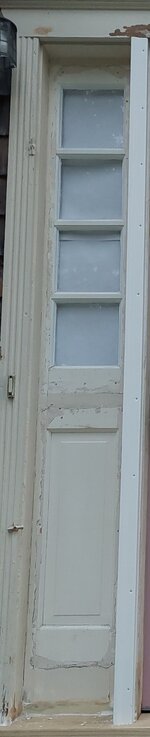

I want to remove large amounts of caulking from painted wood. I tried scrapping by hand and it is a labor intensive process. I know there are products out there that will soften caulking for removal. I do not know what type of caulking it is. What can people recommend for use on painted wood?

Is the caulking in a wood-to-wood joint, wood-to-wall, or just random whoopsies that need removed? Make sure you're realistic about your expectations in regards to having to repaint the trim unless it's just a few dabs of crappy caulk. Doubtful you'll get a chemical to strip or soften the caulk without also damaging the paint.
If you really want some useful feedback, include a pic for reference.

I already got a few good ideas but more is better. The challenge is always if you provide too much info it gets long and confusing to many. Many won't read it and you get off topic divergences. Like, "why don't you just board it up or replace the door assy". I am now being sarcastic but not by much. However you made your point using sarcasm. I get it and I will post a pic.
The caulking was used to mount plexiglass sheets over both left and right side lites. I assume it was a cheap, fast attempt to get some insulation properties. But i dont know as the previous owner did it. They are unavailable to even ask.

Here are 2 pics. An up close and a full view. The up close pic is an area I did scarp and can not very easily get the remainder off. The caulk is mostly very well adhered and a bit rubbery. A small amount (< 10%)was brittle and came easily off.
There are two side lites that are about the same.

I had to remove some silicone caulk from a motorhome exterior. I used Krud Kutter caulk remover to help soften it up. It’s not a miracle worker but it does help, especially if you score the caulk to let it penetrate better. It’s still labor intensive though.

You just have to work it. The multi tool does work well. If you don’t have one look at Harbor Freight. I think you should be able to peel this with a razor knife. I just re-roofed a bay window on the place we bought last year. I knew on first glance that it was going to be necessary. The PO must have had and injection gun for his caulking needs. It took 4 hours to remove a “rope” of caulk about 2.5x2.5x48”. Bitching and cursing are permitted when removing caulking compound.

The Krud kutter looks like one of the best chemical helpers. It says it is ok to use on wood. The others I have seen do not. Unfortunately it is not available locally for me. Out of stock or only an internet order.
Good ideas.

That’s ugly. I’d probably start after it with my gasket scraper. I’ve used a multitool as a scraper, but that area will be challenging to do that way without creating more damage. I used 3M caulk remover once and found it ineffective.
