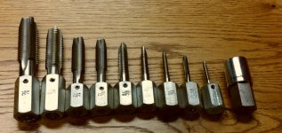

Picked this up at a pic. Very little information out there on these. Any help? I found the website.

Imagine tapping a 4" square piece of 1/4" thick steel...
Drill the appropriate sized hole in the steel. Place the steel on the base plate of your tapper. Insert the appropriate tap into the upper gizmo on the tapper. Lower the tap to the hole in the steel plate. Move or insert that screw in the base plate so that it restricts the rotational movement of the workpiece. You don't want the workpiece hard clamped, you want it to "find the bit" and be able to move so the tap will self center. But you do want the workpiece to keep from rotating so that the tap can do it's thing.
When you want to back the tap a half turn to clear the chips, I guess you'd have to manually hold the workpiece in this style tapper. Some have a sort of floating vise that restricts rotation in either CW or CCW direction.
I have the Chinese style they sell at Enco and other places. I think it's one of the most used tools in my shop. Much easier to setup and use than the drill press method.
Limited, of course, to the size of workpiece you can fit in there.

...you want it to "find the bit" and be able to move so the tap will self center...
When you want to back the tap a half turn to clear the chips, I guess you'd have to manually hold the workpiece in this style tapper...
When you need to reverse the tap for clearing chips, that is the time to clamp the work--it is already centered.
Clamping it DOWN to the tool's table virtually guarantees you'll change the angle of the workpiece in relation to the tap - asking for trouble. The Enco China style clamps the piece but still allows fore and aft movement. So the bit still lines up correctly and stays aligned in CW or CCW rotation.
You could do about the same thing on the style tapper in this thread with pins, bolts or vise grips placed on the TABLE (not the workpiece) so that the corners of the work BUMPED into the obstruction as it tried to turn with the tap.
But once I start a tap (or a drill) I don't want to start clamping or re-clamping the work.

The tapper base is your datum. The rotating shaft is perpendicular to this datum. Downward pressure on the tap holds the workpiece tightly against the base. So, once you have the tap centered and started, there is no danger of the workpiece moving out of alignment when clamped to the base.
