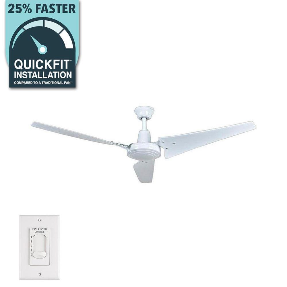

I’m installing two 60“ industrial ceiling fans in my new pole barn. I see most switches are rated up to 1.5 amps. A single fan, on high speed, uses 1.04 amps. Will the switch “burn up” if I install 2 fans on 1 switch? Basically 2 amps on high through a 1.5 amp switch.

You need an "Industrial" "Multiple fan" control. The industrial controls will get you above 1.5A on the motor control and you will need a specific "multiple fan" control if you are running multiple fans off a single switch. Even if you can find a switch with the needed amperate, it will make a horrible humming noise unless it is rated for multiple fans.
Here is an example of what you need: https://www.canarm.com/hvac/mc-industrial-ceiling-fan-speed-controls.html
^ BTW - I recall these have large heat sinks on the back side of them, so you may need a large or special box.

Thanks guys. Here is the switch I was looking at:
And the fan:
I would run them on low/medium the majority of the time (keeping it under the 1.5amp rating) but I don’t want to create a hazard. Thanks for the link to the industrial control. Be nice to run one switch and circuit for both fans.
I tried this on similar fans with a similar switch. It burned up. (Like all motors, there will be a surge of power as it starts up.) It also hummed before we got the smoke and sparks.
I decided to go cheap and landed on a 2.5A Lutron switch. We still get the humm, which is horrible but we never use the fans. ... So, we haven't been compelled to buy a proper switch.
It looks like Lutron has the SFS-5E, which should do the trick for you. https://www.lutron.com/en-US/pages/SupportCenter/support.aspx?modelNumber=SFS-5E&Section=Documents
I don't think you will find it in the Decora line, but the Lutron will fit a Decora plate.

Unless it says "multiple fan", it doesn't have the electronics to handle multiple fan motors on the circuit. When I was looking for controls a few years back, I wasn't able to locate any options from Leviton. Lutron was the only option I came across in a residential style. <- BTW - These switches also have big heat sinks on the back of them. So, having a large box is essential. For a single gang box, I highly recommend using a 4X4 with a mud ring. Shallow/small boxes won't work.

Perfect! Thanks for the info. I might have to change around my switch configuration a little I guess then so I can use the deeper box :(
