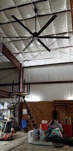

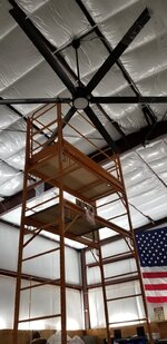

Well it's been a while but I finally started making some progress on getting the fans up.
Had to make my own bracket to hang the fan from the purlins. Of course I thought that the Home Depot kit would work but it was only 24" wide and I needed 31. So I had to make a longer tube that just fit over one of the existing in the kit.
Running the electrical was no fun as well. I have a ton of 3/4" EMT so that's what I used. Never having really done conduit before it was a struggle. Wasted a few bends/material to get things to line up (mostly) . At least it's high enough up in the air that it wont bug me too much.
Once I had the fan installed in the mounting, getting the blades on was fun for a guy who doesn't like heights. Dangling my feet outside the scaffolding trying to get those little screws started. Luckily I was able to move the scaffolding around so that the last blade would fit inside the scaffolding and I could slide it out. Putting on the light on the underside totally sucked because those little screws...I dropped one while trying to put it in...so another trip down the scaffolding and back up.
So now I need to run my conduit for the switch, finish the wiring and hopefully get it done by this weekend. I mentioned in another thread, this would have been a couple hour job for an in the house, 8' ceiling but this thing is kick my behind. I still have one more to put up but luckily most of the work is done and I have some experience. LOL
mike93lx
Dec 9, 2013
38,398
Richmond, VA
That's a big fan
On the scaffold, I've seen people run ratchet straps diagonally to tighten them up. Might be worth it the next time you are up that high

So I got both of the HD fans up. Putting up the second fan was sooo much easier/quicker than the first one. Mainly because most every tool I needed was already up on the scaffolding from putting up the first one so not as many up and down trips.
Here is my general review of the fans.
  • Installation was pretty straight forward, if I could have easily changed the height of my scaffolding then it would have been a bit easier to attach the fan blades and lighting but I was able to get through it with one height.
  • I have a 20' ceiling and I used a 4' down-rod (not included)
  • I also purchased a down-rod wire harness...first off, it was just 4 pieces of 14g wire and 4 wire nuts and I could have just made them myself. Second, the wires coming out of the fan were already about 6' long so I didn't need the kit.
  • The safety cable is only about 2' long so not long enough to go my 4'. I added 4' of small chain.
  • Their max speed is 60rpm so not super fast (I knew that going in). And they do seem to move a bit of air although not a ton like I'm sure a Big *** fan would. I would say it's a nice slight breeze and it move the air around the shop nicely. Certainly gives the cooling effect but for sure not like you would get from a small fan in your living room.
  • It is very quiet.
  • You can turn the fan and lights on and off, adjust the fan speed and direction via the remote control. It also has a "comfort breeze" mode that cycles the fan through various speeds. I don't think with the height of my fans that it would do much good for me.
  • Because the fans only spin at 60rpm max, with any lighting above the fan it will cause shadows on the ground. Luckily I have not put up any permanent lighting yet so when I do, I will make it just below the fan height.
So I think for the money they are pretty decent.
