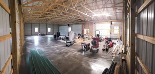

I definitely want a safe, dry heat. Ideally, when painting, I should be pulling heat from the new area into the old, through paint booth filter blanket media, and then exhausting my fumes outside. So, I really shouldn't have to worry about solvent meeting flame and I plan on having the stove pretty far away. I also think the liner panels would help bounce some infrared out into the new area (2560 sft)
See pic below with my crappy markups. Pic is taken from proposed stove location. Center overhead door leads to old area (paint booth).

I definitely want a wood stove, whether it's a barrel stove or freestanding EPA style with glass door on the front. I don't want to mess with the ceiling so the flue will elbow out and then go up next to the gutter outside. I'm going to have three 24" wall mounted industrial fans strategically placed around the perimeter about 9' high to move the heat around. They can be angled up and down.
