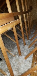

Here are some attic photos and a pic of the ceiling where I'd like to locate it.dd09a7e6761d4c633813e2a5abfed258.jpg758f6af47864cf7b3bb675caec60f026.jpg5fcec1dc3b53b1c829ad1b891030424f.jpg5fafe24a2dd68ef68d3310de0e836c02.jpg

matt_i
Mar 14, 2008
10,723
SE Michigan
Those HF cable hoists rotate or are affixed to rectangular stock with a set of upper loops.
But he has a roof mount storagey compartment...like 200-250 lbs max?
I have one attached to a pivoting staircase. I can lift it, guessing around 100lbs out at the end, but its heavier than I'd like to handle regularly, hence the cable hoist.
Its also supported by 2 double-gangs of trusses.
And supported by pillow blocks so it can easily self-align with the pivoting load center.
As I posted earlier my admonition is that you're playing with fire at 1000, 2000, 4000 lbs....
Sureshot
Jan 3, 2011
3,134
Bridge Creek, OK
The Harbor Freight hoists that say 1000 Lbs are actually 500 single line and you would have no problem doing what you want. Lots of engines have been pulled that way. Think about two grown men hanging from a truss-no problem. Straddle a couple with whatever and enjoy.

Jackfre
Dec 26, 2010
4,406
N CA
I have attic trusses. They are spec'd to a 40#/sq ft load. I cut a bay between the trusses and hung a 12v electric winch. The opening in the ceiling is covered until I want to lift. I would never work under a load that was "suspended" as you describe. I would always be looking up at the attachment points. If anything is going to come down I want it to take the building with it. Also, by getting it up into a bay you have more clearance to the ceiling in the lift.
Thanks everyone for the replies!
What do you mean by suspended? Because what you're describing is what I had in mind, I think. Have a door cut that is in place that I remove and drop the hoist down when I want to use it.
