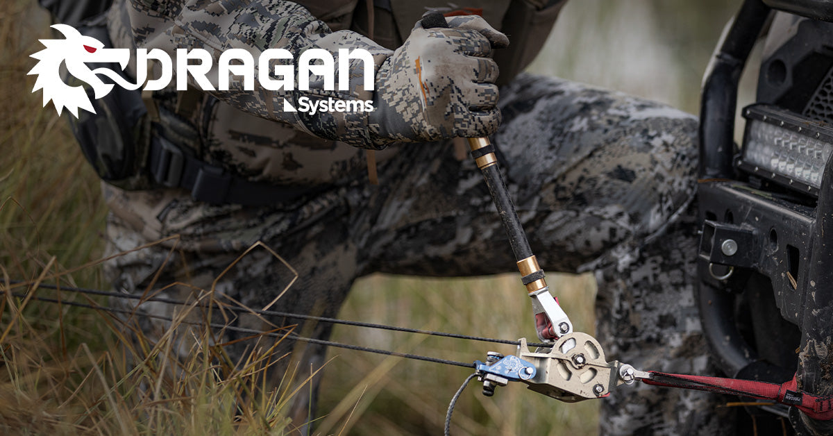

You linked a chain hoist, which is for lifting, but your use cases involve dragging. Dragging something with a chain hoist like that would ****. You need a come-along. And when it comes to come-alongs, one stands alone:

It's not that they wouldn't work. They certainly can be used for pulling/dragging, that's just not what they're made for. They're heavy (75ish lbs compared to the Wyeth Scott's 25 lbs for comparable pulling power), they have short pulling capacity (10 to 15 feet compared to 35 feet for the Wyeth Scott), they're slow (someone else mentioned this above), and all the extra chain is just laying on the ground in the dirt or mud or grease rather than being neatly coiled around the spool.
Driving nails with a sledgehammer works but that doesn't mean it's the right tool for the job.

I very much appreciate everyone’s contributions on this topic. Based on the input here and taking my intended use along with price into consideration I am now looking at the Wyeth. I haven’t ordered yet so still interested in additional suggestions and experiences with the different types of hoist available. Thanks,
Amazon.com: 3 Ton Ratchet Puller With 35' Of 5/16" Amsteel Blue : Automotive

Only negative is the rope has a tendency to wedge itself between the rope on the spool on tight pulls so the next time you use it you may have to use something to help pull it out
