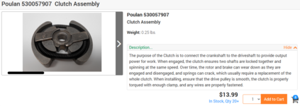

Where did you see a spring here?
It's quite obvious if you open the picture of part #6 the clutch.
To the OP, I'd suggest that you replace the clutch and the clutch drum. Common wear/repair parts in a chain saw. Some suggest that the clutch drum be replaced when a new chain is installed.

With the new clutch costing less than $20 including the spring to me it is a no brainer to replace it all.
