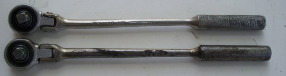

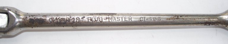

I found one of these the other day in a old Cornwell tool box that I bought. At first I glanced at it and thought it was some cheap import throw away being that it said Champion on it but upon further investigation it is actually a very nice ratchet. I think the previous statements are right on that it was made by New Britain as the handle is exactly like other New Britain and Blackhawk tools I have. The guy who owned the tool boxes I bought stopped working in 1965 so it has to be at least that old.

I have one of those, it was given to me as an Xmas gift from a parts store, in about 1968 I believe. I'll have to look at it and post a photo

I've never seen a NB sourced ratchet with that style of cover, though. Can we confirm it as a NB? Where is Dieseldodge? He'll know.

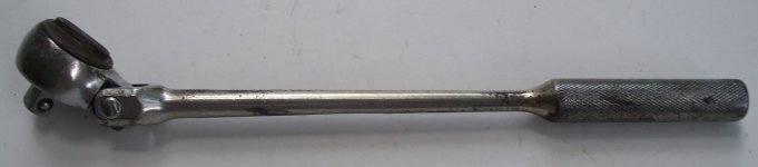

A real nostalga trip.....I have one of those, it was given to me as an Xmas gift from a parts store, in about 1968 I believe. I'll have to look at it and post a photos:

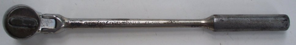

I think I found proof today that it is a New Britain sourced ratchet today. I bought this Blackhawk version of the ratchet that is exactly the same as the champion one at a pawn shop for $1 since it was bent up at the head (I hope I can straighten it with the press). It is the EXACT same ratchet part for part it just says Blackhawk instead of Champion on it and has the Pat number on the other side. Here is the google patent search on it.
http://www.google.com/patents/about?id=HXlpAAAAEBAJ&dq=2554990

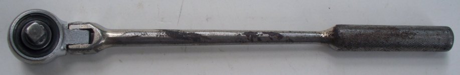

Straightening it in the press shouldn't be much trouble,I've done a few worse looking ones.Main thing is to take your time.I usually try to keep a rag or something between the press ram and the ratchet to protect the chrome as much as I can.

Champion / Champion Spark Plug Co., Toledo, OH / "Plug Master" ratchet manufactured by New Britain Machine / "Miloset" spark plug gapper / patent 2439363 Apr 6 1948 Louis A Habicht and Howard H. Vogel / https://www.garagejournal.com/forum/threads/champion-spark-plug-rachet.24974 /
45 tooth sounds about right. It's the Luther Kilness patent design with a bent handle and a swivel head.

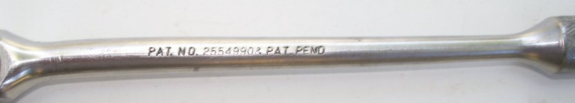

Mine is the CT-405, straight handle, but with a Pat Pend mark, so pre 1961 then?
:unsure:
The Kilness patent I cited above was for the NB type ratchet.
Your "Pat Pend" causes me to wonder if there was another patent they were using on that one?
(I was assuming it would have been the Kilness 1951 patent because the advertisements I posted above are both from 1958.
Kilness was issued another patent for a very similar design in 1961.
Somehow I just can't see Champion Spark Plug Company applying for or receiving a patent for a ratchet they outsourced. :unsure:
