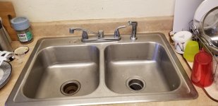

I installed a new sink, faucet and disposal, I still need to check for a ground wire.
