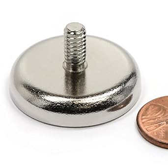

You can get little magnets with a threaded post on them. Put the post thru the hole in the clip and attach the magnet to the ceiling. No trim board necessary.

Very true, but these lights don't have any way to utilize yours in that way. They are not even 1" wide, and the brackets are dinky.
I picked up some of the Costco 4000 lumen 4k lights and like them so far, going to set them up this weekend and I know I will need that trim board - they don't have any easy way to attach other than eyelets like you would find on a power strip..... I might just drill some holes.
I definitely know a few uses for your magnets though, there are some things I want to attach that I can't easily screw into, yours would work perfectly.
I know they are. I use them. You can get the magnets small enough so that the post fits thru the hole in the mounting clip.
CD
Mind blown.
Well, now I must scour the Internet for them, unless you have a link, lighting wizard.
