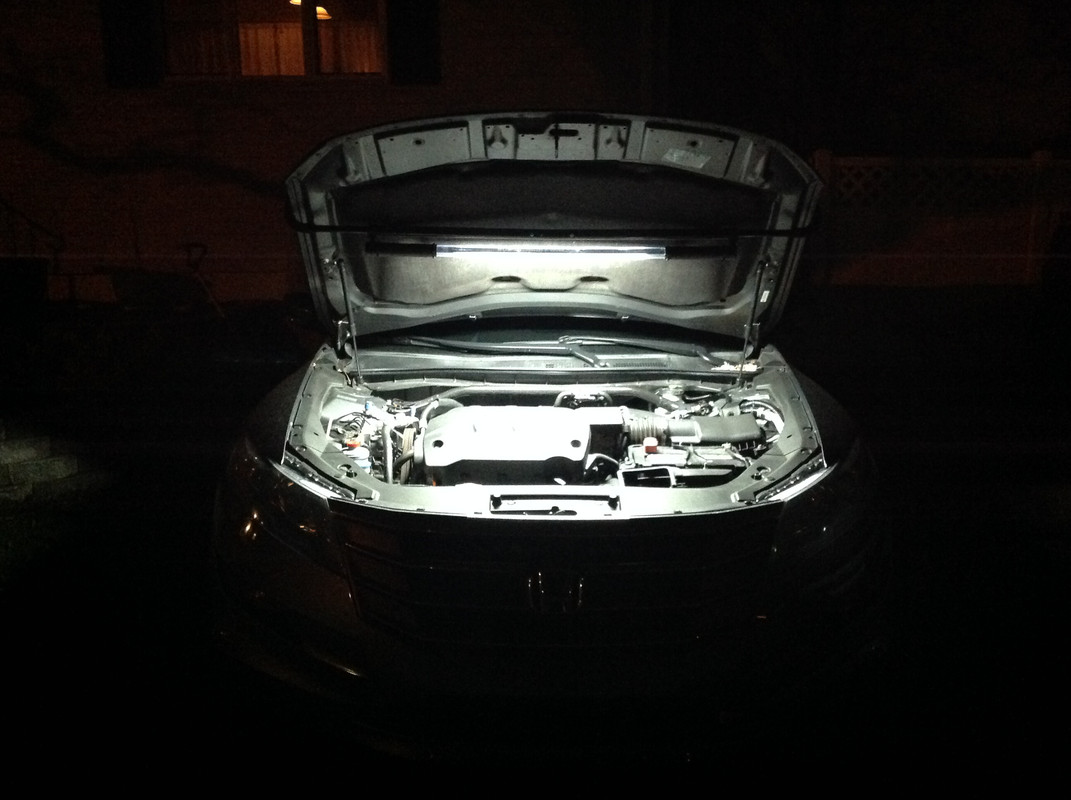

This is the older Neiko on high

Excuse my ignorance but is this light installed permanently?
No.. its a temporary work light. Depending on model they mount differently, either by hooks, magnets, or a spring loaded bar that can clamp right onto the hood of the car. Its just a better light to use over a drop light, flashlight, ect.. it can light up the entire (or most of) the engine bay.
