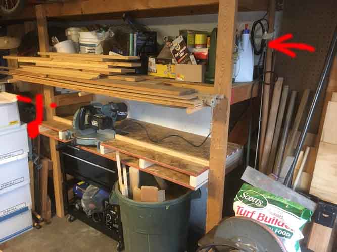

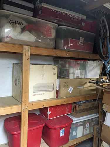

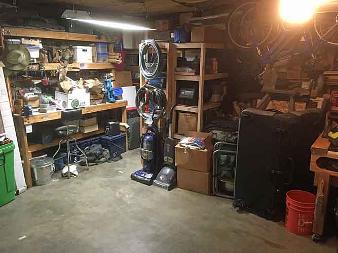

So I finally built those shelves, and here's what I came up with:
Materials were roughly two sheets of 23/32" OSB at about $16 apiece (I say roughly because about half of it was from pieces I already had), a few chunks of 2x4 from my scrap box, glue, and various fasteners (nailgun nails and brads, and six screws to attach the finished units to the wall). So let's say $35 in materials to put up a total of 24 8"x28" shelves, or roughly $1.50 per shelf.
The shelves are removable (except for the four at the corners) but fit snugly enough to stay put. I think the OSB will handle the 28" span without sagging, but if a shelf does sag I can flip it and/or attach a reinforcing rib on the underside.

Well done, dwasifar! You made use of that entire wall and got a ton of shelf space.
BTW, what kind of ceiling light fixture is that?

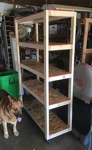

I've got tools, ammo cans, car parts, gallons of paints and sealers and a variety of other heavy goods. Any sort of shelf that is solely made from sheet products is not going to hold up without sagging. Even for something like canned / jarred foods.
You need to have some sort of frame structure to support the shelf and too, then, you can use thin sheet goods without trouble. I've made out full-length garage wall shelves with 2x4 frames and 4-5' spans. And recently some rolling shelves and other mods using 2x3s, topped with 7/16 OSB (speaking of cheap)
Too, with a table saw you can readily rip thinner sheet goods in 16" strips (that's 24 linear feet out of a full sheet), or 18" and get 16LF
An 8'L x 7'H x 16"deep shelving unit can be made with (11) 2x3s or 2x4s and (1) 4'x8' sheet product of your choice for <$60 plus hardware.
For that you get 32sq' of shelf space, 85cu' of volume and shelves nearly as strong as a Gorilla Rack costing 4x as much.

what sort of lightweight brick-brack does the OP intend to put on those shelves, besides empty boxes?
If you look through the open doorway in my first picture, you'll see a shelving unit made out of 2x4s exactly like the ones in your pictures. :)
