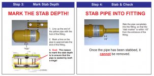

It's fairly easy to install Polyethylene Gas Pipe using Constab type fittings. You cut the pipe to length, they make a tool that chamfers (knocks the edge off) of the cut pipe and then you just insert it into the fitting. These 90's get you above ground and from there (at least in my area, you use black iron). Once your done, pressure test for 24 hours.
Of course check with your local building department for whats required in YOUR area

The answer is medium density or high density polyethylene GAS line. It must be manufactured for/sold for the gas usage. It will actually say "GAS" on the pipe. They make PE water line too. You can't use that.
Plastic can only be used for natural gas service underground. So, on each end of your line you will need to buy and install pe to steel anodeless service risers. Two of these will likely cost more than your pipe...but you'll need them to transition from plastic back to NPT Steel. For your application you'll want 3/4" or 1" pipe and risers depending on distance you have to go....I didn't see that in your post. If 100 feet or less 3/4" would work...but 1" would work for that or greater distances.
You will need to either heat fuse or use mechanical stab couplings for your joints on the PE. Most lay people choose to use mechanical stab couplings. The directions to install are on the bag. Follow them exactly and you should end up with good joints.
Use a shut off valve at the beginning of your run.
Put 14 gauge or larger solid copper wire in the ditch and bring up at both ends and wrap it around the riser so someone in the future will be able to locate your pipe with a pipe/cable locator if needed for future excavation.
Call 811 before you dig.
