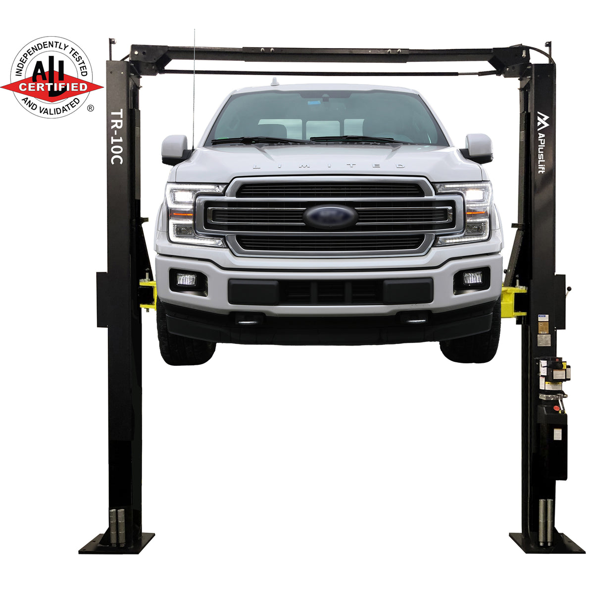

Get ready for everybody to tell you that you will die if you don't spend $12k on one.
I've been really happy with my APlus lift. They have warehouses all over, usually free shipping, and headquarters in WA since 2013. They were really nice to deal with and the lift has worked great for two years so far. I called a bunch and spoke to helpful people every time. I got the 10k ALI certified two post for about $3k, now its more but they have many less expensive options. I know the ALI certification isn't a guarantee on quality but I figure it helps, and I never come close to the 10k rating.
