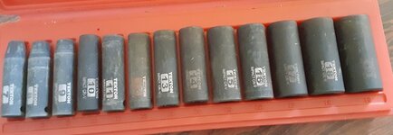

I bought a set of 3/8 deep metric Tekton CR-V impact sockets about 3 years ago.
Light DIY use only, good sockets, except that the size markings on frequently used
sockets have worn out.
I wonder if other brands are marked better.

Tekton's newer impact sockets have both laser and stamped size markings.
