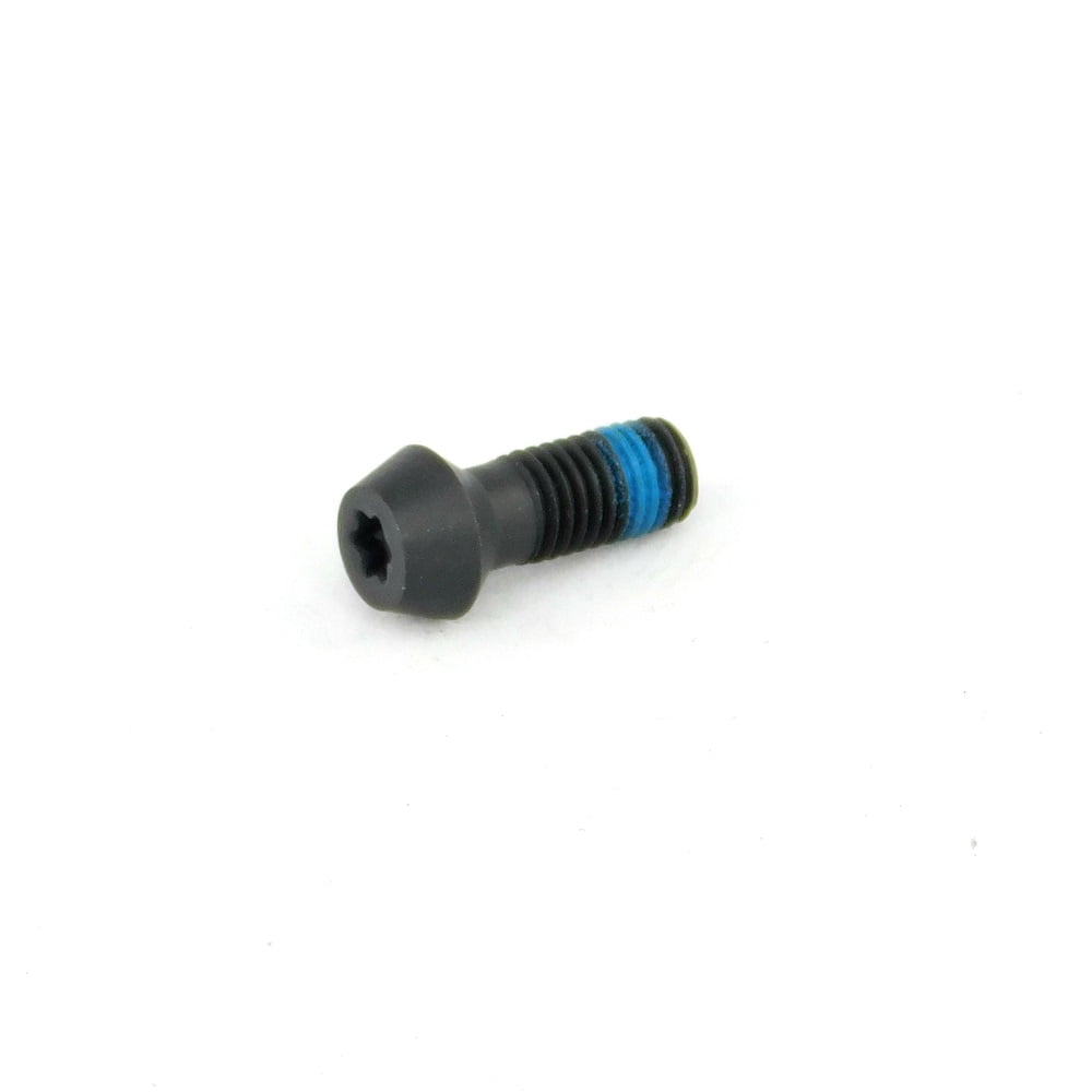

Hello everyone,
I recently posted about my Wen All-Drill 950 1/2" electric drill. It's badged as a Penncraft, but the magic of Google Image Search revealed its true origins. I took it apart to do some cleaning and re-greasing, and discovered that the chuck retaining screw was missing.
If it's anything like the other drill I've worked on recently, it'll be a reverse thread. I took the drill into my local Ace Hardware, and asked for a reverse thread screw, and they looked at me like I had three heads. Back when I worked there, the more seasoned employees would have known exactly what I was talking about and whether or not they had such a thing, but I digress... They had reverse thread bolts, but they were too big for this application.
Attached are some photos of the chuck itself. Given the mass production that Wen was noted for, I doubt the chuck shaft is anything unique or proprietary.
The text on the end of the chuck looks like this: "=MC8K64=1/2-20 THREAD= CAPACITY 5/64-1/2="
Any assistance would be greatly appreciated. Other than this, there's no good reason not to use this drill and put it to work. After all, that's what it was made for.
This part should give you clues. The 1/2-20 is pretty standard, so finding another drill with a 1/2-20 thread on spindle MIGHT have the same left hand thread screw to lock it on. Some parts diagrams give the size for “standard” stuff, you might get lucky, you might not.
You might find someone here who has time to take one apart and look also. I won’t see the inside of my garage for several weeks.
Example MKE 1001-1 drill, part #48, but it does not say the thread size on the chuck, so don’t take this as gospel. Also, in the chuck description, it describes left hand threads, but not on the screw.

I had a Craftsman reversing electric drill that had a similar mounting. If I remember right, the chuck and spindle were right-hand threads, and the retaining screw was left-hand threads.
This makes sense, as the forces on the chuck while drilling with normal drills would tend to tighten the chuck onto the spindle. Only in reverse would the chuck try to unscrew.

very likely it's a standard LH thread. I would take a drill bit that fit the ID of the threads ( the minor OD) and see what that is. then go to the good old search engine & find what that measurement corresponds to. It is probably a fine thread .
I had to do this with a compressor head that I bought missing the LH threaded bolt that retained it. I found it was a 1/4-28 LH. had a very difficult time finding one... I figured out that a dewalt cordless drill had that size screw. Ordered one up & it fit the bill.

I have a number of 1/2" Reversing drills with Jacobs chucks
different mfrs....Milwaukee, Porter Cable, Dayton, and Rockwell
All of them use similar if not the same reverse thread retaining screw...
Meaning that the screws will interchange, sometimes the screw head is taller and requires a deeper relief in the chuck, but they have the same reverse threads.
So......perhaps you can try checking with Jacobs?
See if they can point you in the right direction or simply send you a retaining screw

Here is the response I received from Jacobs after filling out their contact form a few days ago:
Thanks for your message.
MC8K64 is Jacobs 1/2" Multi-Craft keyed chuck with ½-20 threaded mount.
Usually, it uses 1/4" or M6 retaining screw (left-hand). The retaining screw size was determined by Wen, not Jacobs. It was screwed on the drill spindle.

Back OT: Being Wen, and China, it's almost gotta be a metric screw. 6 X 1.5 left-hand?
W
Aug 14, 2023
23
Tennessee
Remember, this is one of the vintage, US-made Wens from the late 60s, probably made in Chicagoland, so it's more likely to have a standard thread. I went ahead and ordered one each of the screws mentioned in previous replies. Also, I posted a previous reply where I included the response I received from Jacobs.
