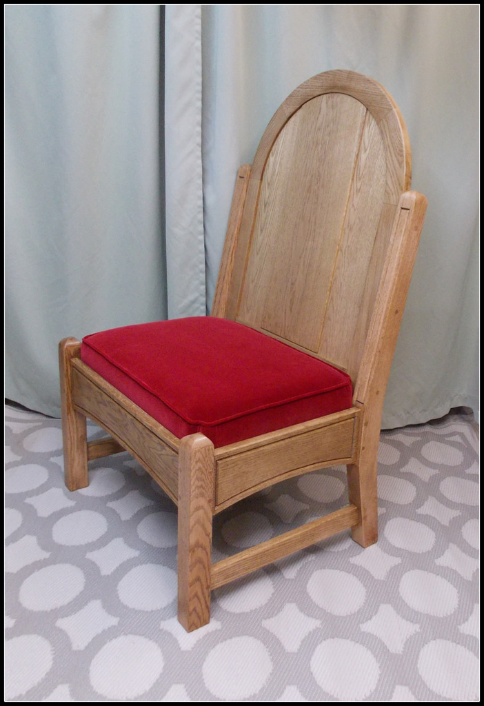

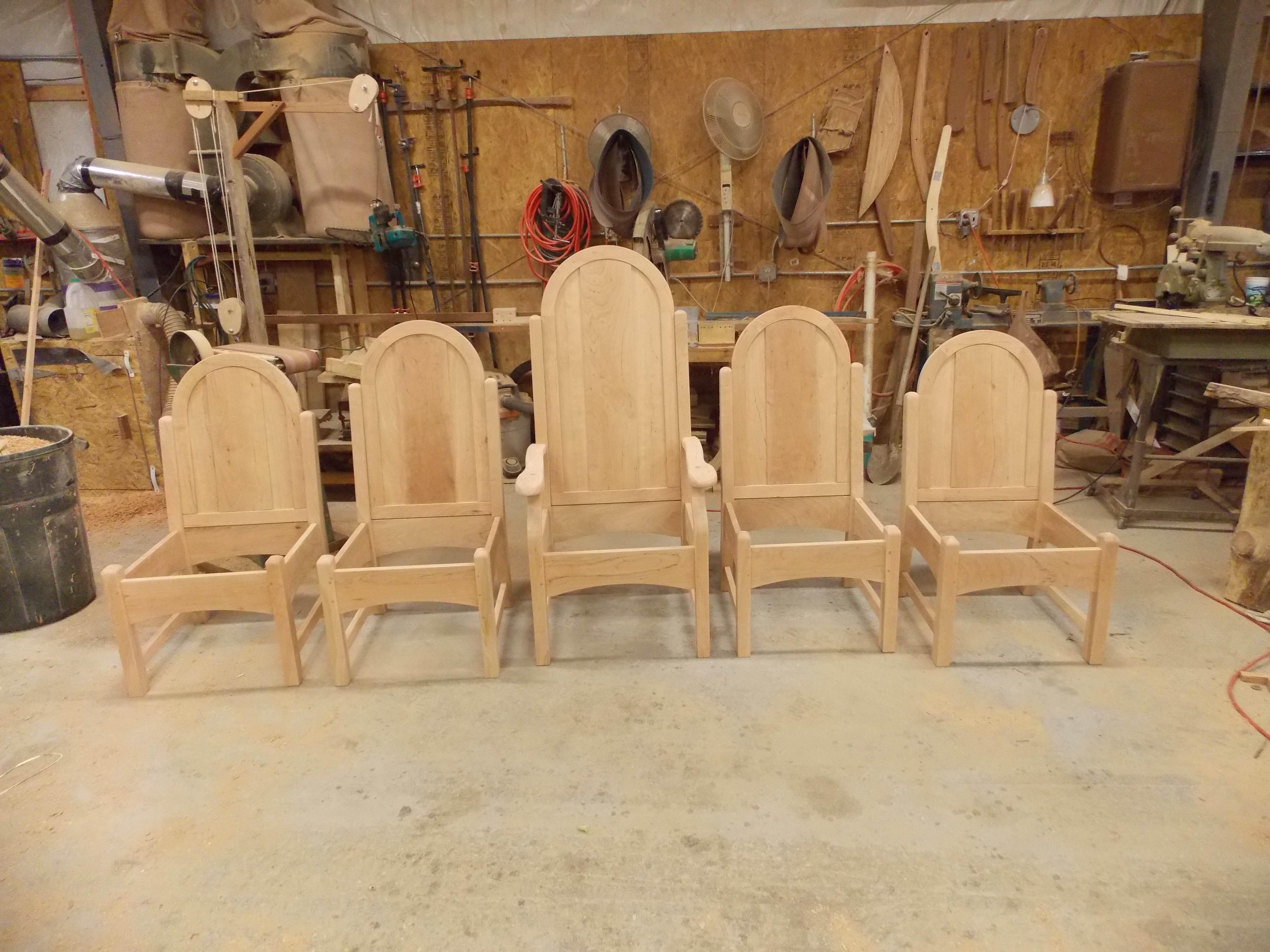

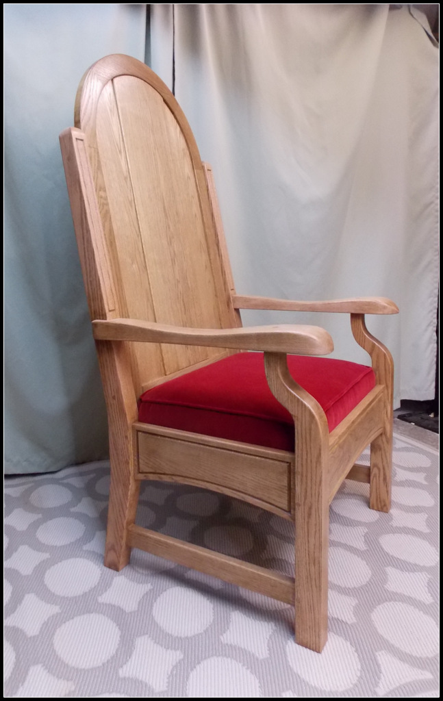

Made some oak chairs for a church I had designed this style of chair for another church ten years ago with a few size modifications just made these.
The upholstery was done by a new shop that just opened up near me I am very happy with their work.
Had a deadline so I forgot to take many in process pictures.

Functional pegged stub mortise and tenon joints. You didn't want to go all Arts-and-Crafts with contrasting pegs?
The chair backs are solid wood? Did you do a tenon on the back panels to go into a groove in the back frame ala typical frame-and-panel construction?

I start by designing them in CAD, the joinery mortise ant tenons I now do on a CNC router utilizing the cad information. The shaped parts like the legs and aprons are done on a pin router the patterns for them were cut on the CNC.
The back components are cut on the CNC router.
MoonRise
Yes the backs are solid wood I resawed oak for the inner panels.
The back frame is slotted for the panel insert.
The stain is Varathane golden oak to match the rest of the church.
Topcoat finish is Varathane waterbase floor finish been using it for several years with good results, it is harder to spray than the catalyzed lacquer I used to use but is as durable or better.
