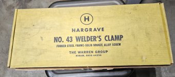

I have some 10s of the 540 standard clamps, and an 8" of the No 44. Nothing from the No 43 line.20260106_211808.jpg10s, 12s, and a 14 540. One of the 12" clamps is a Chicago
