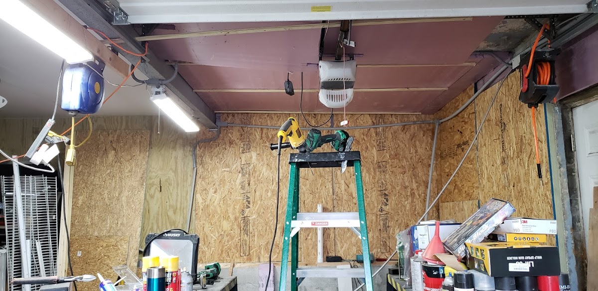

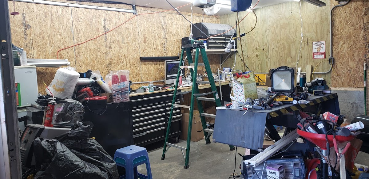

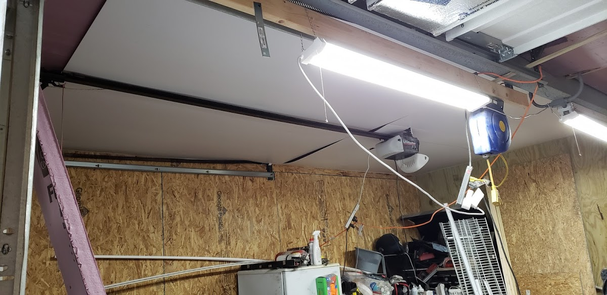

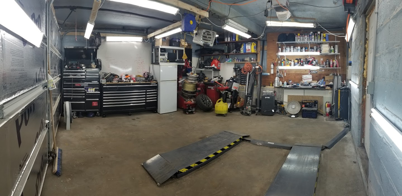

2020 -- Redoing the garage to make it more comfortable:
Removed compressor and tire machines:
Added a shed to house the compressor and tire machines:
Clear out walls for R5 insulation:

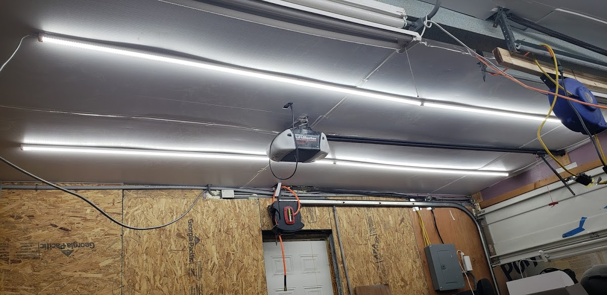

Added R10 to the ceiling:
Added OSB/Plywood to the walls:
Added corrugate plastic sheets to cover the ceiling foam:

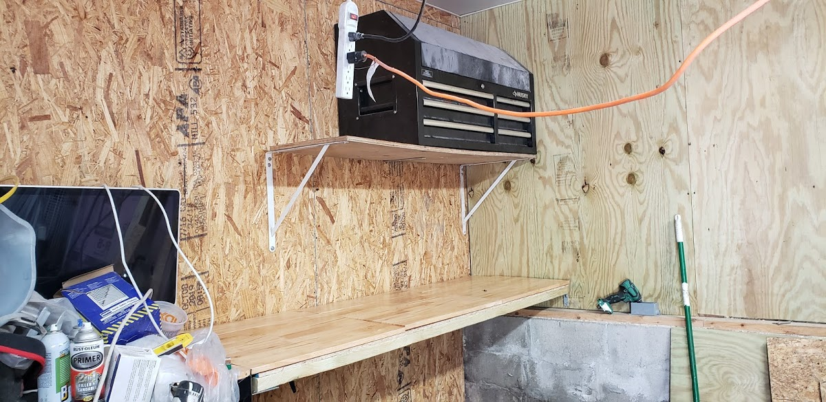

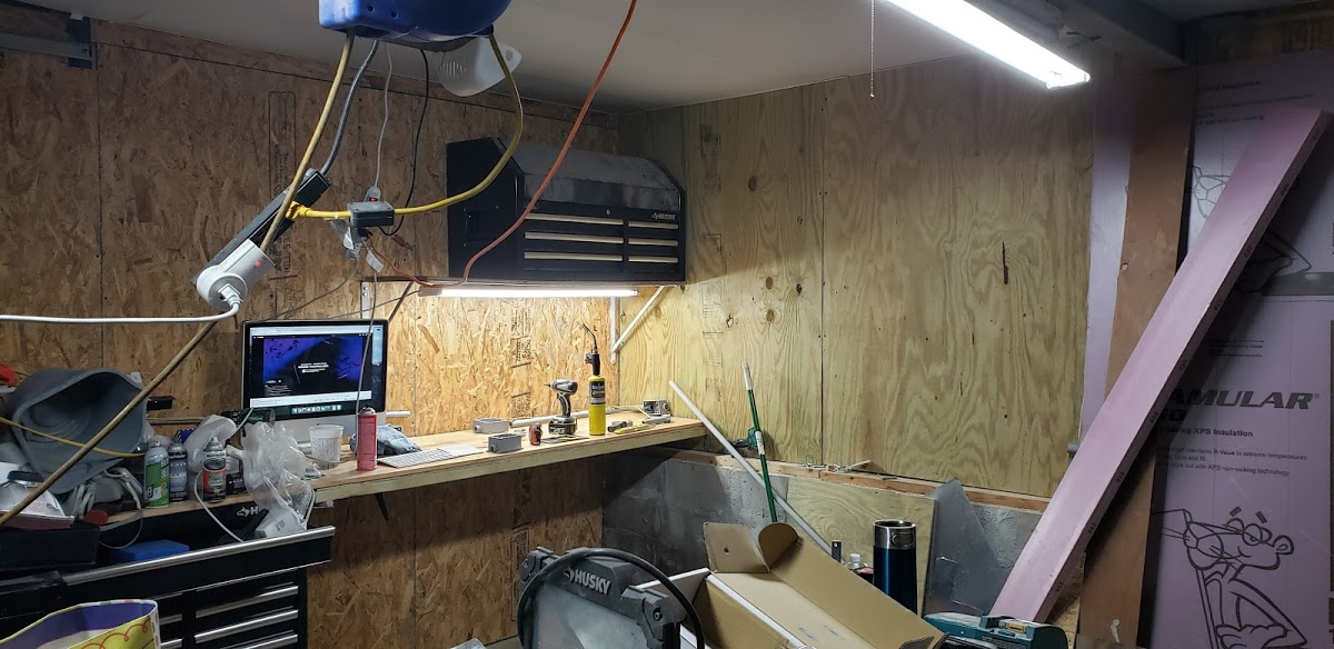

Built workbench and separated bottom and top chest:

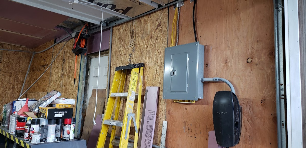

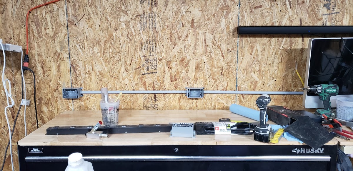

Added new conduit:
Added 4x 8ft LED lights on both sides:

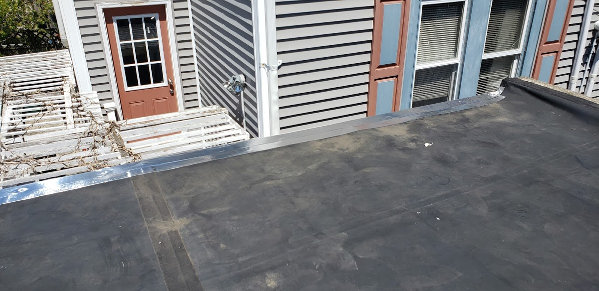

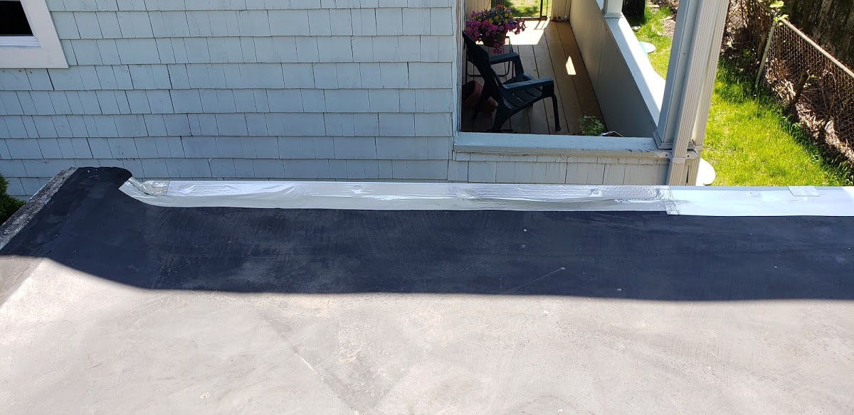

Fixed the roof edges as the rubber shrunk and exposed the garage to leaky walls:
Added wiring for outlets:
Added cabinets above workbenches:
Re-routed lift hydraulic lines for easier operation:
That's it as of this week

Nice little garage. Have you used it during the heating season yet? Did the heater cycle On/off a lot?
Not sure if I want to stand near the right upper top chest. How is that bracket secured to the wall?
Last question is can you hear the compressor running out in the shed?

Thanks -- I usually ran the heater on max until it was comfortable then turned it down half way. Now under the car it was decent, however when I had the car up on the lift and I was standing on a stool, anywhere above 6 feet was too warm.
The plywood is bending but there's a total of 4 brackets under the wood and all of which cover the 18" of the plywood depth itself. All of which are hitting studs. So the only concern would be if all the drawers were pulled out and pulled down.
The shed is next to the garage with a 1 foot gap for the AC, I hear the compressor through the pipe connecting the garage and shed but very minimal. A standard power drill would be louder than the compressor. With some background noise -- I probably wouldn't even notice it
