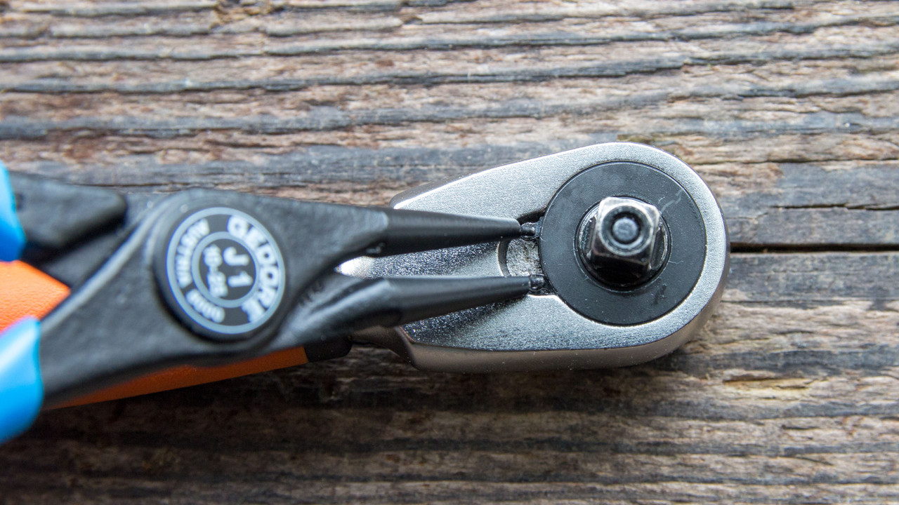

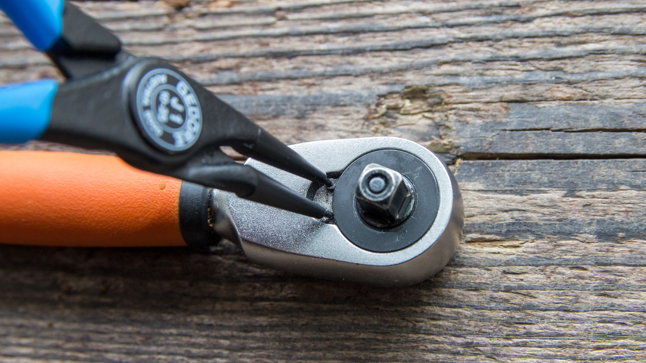

Regarding access issues. I bought Facom with a similar design to Knipex precision and found that the thicker jaws blocked my view of the tips on the smaller sizes so I sold them and bought standard Gedore which have thinner jaws. Hopefully the designs of these pliers are close enough to the two Knipex styles to be relevant.
This was my experience. Results may vary. Pics were taken for another thread posted a while ago and are simply a visual representation of my findings. Not intended to be an exact scientific test or proof of anything :thumbup:
Gedore on the left. Facom on the right.
Only way to access the ring with the Facom is directly from above so it is difficult to see if the tips are in the eyelets. (Same issue with the 90 degree jaws)
Approaching from a similar angle with the Gedore. The tips and eyelets are more visible.
Due to the thinner jaws on the Gedore you can approach from a steeper angle clearly seeing if the tips are engaged before straightening the pliers and removing the ring.

Those Gedore's look really nice. A big difference with regards to seeing the circlip. A 6pc set would be pricey though I bet.
