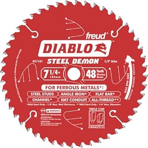

Name 1 that will do a 8' cut in 1/4 plate and leave a clean straight edge.
A $30 Freud metal-cutting blade with that saw will leave a cut so clean you can see your reflection in it.
ADSR
Jan 12, 2013
10,713
Agreed! I bought one to do metal roof and siding. I've also cut 3/8s steel with it. It cuts awesome. Also, there isn't the burning smell like the other discs.

I've done the abrasive wheel in a circular saw. My take? Its awesome. I wouldn't shy away from it.
I've never tried the diablo metal blades, but I've seen Jack's posts on them and it looks tempting. As I recall he uses a slightly lower sped Rigid 18v saw... correct me if I'm wrong.
Your results may vary, but I know Makita circular saws last a few years with an abrasive disc.
truckdriver
Nov 12, 2009
1,209
Miami,OK
I've cut lots of steel with an abrasive blade over the last 10 years and that old saw just keeps going. I am going to try that Freud metal blade though. Thanks Jack!
