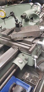

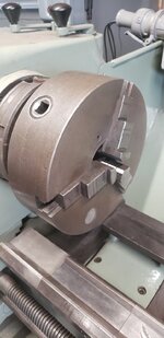

I’m about to purchase a lathe for $2500 that is in great shape from what I can tell.
Clausing Colchester No. 4/35936

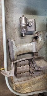

If someone with experience in operating lathes could take a look at these and give me your honest opinion I’d really appreciate it! Comes with minimal tooling, only a 3 jaw chuck, no taper attachment or VFD. I would require the VFD right away but that is no big deal.

Well that looks to be a hell of a deal. I hope it’s in as good a shape as it looks. Congrats!

I see a follower rest, but not a steady rest. Is there a steady rest included, but not shown? One can be built or adapted, but it is a lot of work. A steady rest is really a necessary piece of tooling.

At least being a Colchester lathe they are common enough you will be able to get the correct steady rest, in the UK there is always rests for these on Ebay, probably less common in the states though. But these lathes were built in the 10's of thousands and Colchester still exists and there is still spares around (though they import machines now I believe)
Colchester's were good lathes and a great choice for a home shop, but they were built to meet a price point and there is better out there, but those will be rarer and much heavier usually.

He said there is a steady rest but I have not seen a picture of it; I will double check. I will have a taper attachment made for it if I can't find one for sale.

I have operated several colchesters and they were fine lathes. Lathes that large are not fun with stuff under an inch due to low spindle speeds but its doable.
Looks like you just need to add a cxa tool post/holders and a 4 jaw chuck.

Very clean, I have the same one, not as sparkly.
looks like the gap bed is removed, does the seller have it?

It could be a lot worse, its still a 1200 rpm machine, use HSS to get better finishes on the small diameters where you can't run carbide at the SFM it really needs. Plenty of slightly older machines than that of similar size where top speed might have only been ~800 rpm
Nice lathes that size with 3,000 rpm spindles are not something that come up often at hobbyist prices.

A consideration in lathe size, as pointed out above is weight you speculate running, then the size. Kind of like an X, where they cross is sometimes ideal.
Personally, the #1 facet is what variety of tooling it's built for, starting with the spindle. Most of the other features you adapt to, spindle not so easily.
I've been machining my entire life. A taper attachment is important to me, but have seen endless numbers of them in shops never used. You're in for a l-oooooong hunt having one built, and co$tly. Thou$ands wouldn't surprise me a bit.
It's more common to adapt one from a like sized lathe. Those I've seen in the few hundred dollar range.
Still, that would buy and build A LOT of offset centers, accomplishing same goal over entire bed length. Taper attachments can't do that in one shot, has to be moved in steps.
