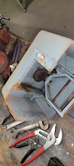

I ended up with the Delta series 2000. Got it under a 100 bucks and it has some serious issues but I think I could fix it. Judging by the table it doesn't look like it's had much use. I think someone tipped it over early in its life.
In any case I notice the Arbor is very low. Is this normal or does this appear to be some sort of adapter that I could change?
The biggest issue is the fork that raises the front Reeves pulley. I'm thinking I will end up fabricating something out of mild steel Since there's no way I'll be able to get this part.
The chuck is low because it's on an adapter stuck in a #2 Morse Taper spindle. There is a Jacobs Taper spindle which will mate directly with the chuck and do away with all the extra length of the MT spindle.
Just me, but I've never understood why so many medium duty DPs came with the MT spindle; most of them always have the adapter/chuck in place, so why not order it with the correct spindle?
