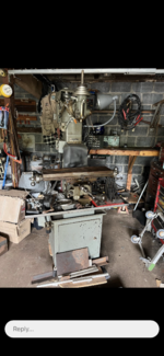

hello,
Got a lead on a clausing 8520 mill. I wasnt in the market much for one, yet, but a friend is selling out his deceased uncles estate.
Hes looking for $4-500. Has some tooling. Dont think it has a vise. 110V baldor 3/4 hp motor.
Should i grab it? Anything in particular to look for? Price seems reasonable i think?
Ways / table move smooth. Seems tight.
It will be home owner hobby use. Its a nice size for my shop.
Any thoughts?

That is normally a 12-1500 dollar mill. If it comes with the tooling then that is an add on price. Why are you still sitting there...go get it. While there look around in the drawers and shelves to see if any other machine related items are there like rotary table, indexer, collet holders, cutters and setup blocks etc.. Take a couple thousand bucks and buy the lot. It is not unusual to spend more on the tooling than the machine.

For a small, light duty mill it's a good one. For that price you really should go get it if you would ever want to do small metal working jobs. It's not the same capability as a larger mill, obviously, but it's a far better machine than the imports. Price makes it a very good buy. Get all the tooling/fixtures that are with it even if it cost a bit more. You won't find that price again any time soon.

I'd rate it as a $700 to $800ish mill.
Doesn't hold a candle to a Millrite or a Rockwell.
And has Morse #2 taper. It's good that it comes with some tooling.

8520 is solidly in the same class as a Rockwell. Almost identical size / weight. Rockwell has the benefit of using R8 instead of MT2 / B&S. 8520 /30 offers a few more features, and better support.
Milrite is a stap above either, but also a significantly larger mill.

I sold an 8520 two or three months ago and got $3,200 for it here in Michigan. We have all kinds of machinery around here, but Clausing 8520/8530 and the Rockwell and Millrite mills are hard to find.
Yours is missing the pulley cover, which is a bummer, but not a deal breaker. The one I had came with maybe $500 worth of tooling, including a mill vise, and had the factory power feed for the X-axis, but those honestly don't work all that well. When I sold it we disassembled it into the three main parts and it went in the back of a full-size SUV with no problem. The guy drove three hours to get it, and said he'd been trying to find one for a year.
Finding an 8520 in decent shape for less than about $2,500 takes luck. To put it in perspective, the Bijur one-shot way lube system yours has is worth around $250-300 by itself so the folks claiming sub $1,000 may not be up on current pricing.

Thanks for the wide variety of responses. Got a call today he threw together a milkcrare of tooling. Cant wait to see what it contains and and pick this up.
Thanks @ gman - for the info on that oiler setup. I was wondering what that was about!

-Good spotting from gman, I hadn't noticed the Bijur until blowing up the photo. The Bijur is/was considered a standard and essential piece of equipment to have on any manual mill, a lot of them didn't have a central lube system when shipped from the factory. On older, used machinery, it's not uncommon to discover the wrong lube had been used by a previous owner that has now caked into something resembling soap. At that stage it's not only failing to lubricate, it's also preventing the correct lube from fully entering the galleries.
It's a small detail but I'd suggest that during cleaning some time is put into checking the oil galleries. Sometimes you can crank the table/saddle/column to end of travel to inspect what's in the galleries, be very careful of hanging all the weight off to the side and the machine tipping over. Use a Q-tip or something to gather whatever old lube is present and give it a good look under magnification. You can also pump a good dose of new lube and check the machine ways, if it's not wet it's not getting lubrication.
If that's the case the only remedy is to pull the table/saddle and clean out any blockage in the galleries and lines feeding them. The correct lube should be listed by the manufacturer. I've seen oil galleries that were plugged up with dried grease where an oil should have been used. Failure to correct a clogged lube system will result in accelerated wear and the machine will start getting loose where you don't want it to. I've had to do this with several machines, Maintenance for metal working machinery gets neglected far more often than not. The same professional machinists that neglect machinery wouldn't do that to their own automobiles, don't know why that is. If you take care of your mill it should be in good working condition for the next generation.
