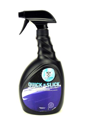

Soaking tools? ...not good.
I've been spraying Croftgate Multiclean on a rag the wiping the tools down, no soaking required.
Then a little Croftgate Quick and Slick on another rag and wipe the tool to protect it from corrosion.
Another corrosion prevention method I use is to take those small desiccant packets you find in pill bottles and electronic packaging and put them in the toolbox drawers every time I find one.
I also have placed my toolbox close to the garage furnace which keeps the area around the box dry.
