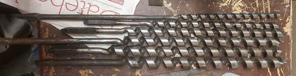

Ah, cute little fellow. Take a look at these ships augers, longer than my tailgate is.
Came out of an 1890s era tool chest, along with a bunch of other tools belonging to a pair of brothers here's a bit better view of them.
This one is a different one, compared to other normal bits
