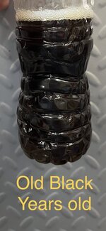

I bought my parts washer 12 years ago and filled it with about 8 gallons of PSC 1000 solvent. Both were from tractor supply.
A week or so ago I decided to clean the fluid with one of the bag filters that northern tools sells.
Here is the 12 year old black fluid I started with and the after 13 hours of filtering. I may stop here because that’s clean enough, and I’d didn’t change that much from the 10 hour mark. Update: added photo from 19 hour mark.
C3-B7408-A-B924-450-F-AE88-B49062-EF4-D8-E.jpgC685576-A-A8-E0-44-CE-80-BA-C7-BBAB323-DA9.jpg
First thing was to drain the parts washer and scrape the goop from the bottom of the tank.
(I’ve done this parts several times over the years.)
Then I set up the bag and turned the pump on.
After a couple hours I had to tilt the left side of the parts washer up to keep the pump inlet submerged. I also opened the pump housing and found that it was full of crud, which I stirred up with brushes to put it back in suspension. Clean out the pump housing along with the tank next time. I’m letting the bag drain tonight, then I’m going to see how much new fluid is needed to keep the pump submerged. I still have about 2 gallons of new fluid from 12 years ago.
For the price of the bags vs the price of the fluid, I do believe this is worth doing.

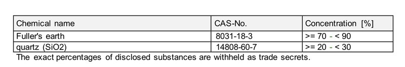

Zep produces them. You can find them cheaper if you Google the p/n. https://zep.com/products/dyna-trap-filter-bag-903402
Thanks for the link!
The Zep site includes the MSDS for these bags.
Here is what’s inside:

Fuller's earth= bentonite
and many clumping Kitty liters are bentonite...
https://iranbentoniteco.com/bentonite-clay-vs-fullers-earth-key-differences/#:~:text=Is%20Fuller's%20Earth%20and%20Bentonite,detoxifying%20and%20deep%20cleansing%20properties.
No, Fuller's Earth and bentonite clay are not the same, though they are often confused. While both are natural clays with absorbent properties, they differ in their mineral composition and origin.
