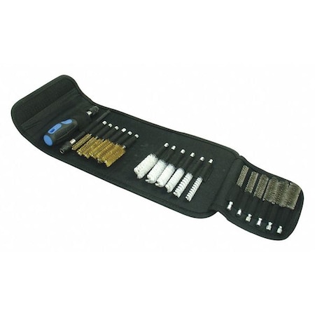

You might consider something like this. No doubt the wire wheel will work but you will also loose some skin from the tips of your fingers and launch a couple of the bolts across the garage. These can be found at many places and there are several choices for the medium used to do the cleaning.
