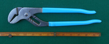

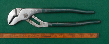

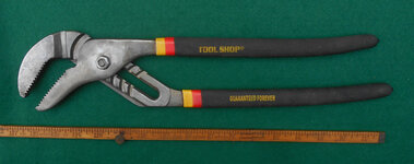

These had all been victims of wanton neglect and abuse - left out in the rain and cold - and required a more aggressive approach. The WD40 and brass brush didn't give me the results I was after, and considering that none of these pieces are really "vintage" or "collector" material (other than the Diamond groove-joints which were already decorated by a previous owner.)
So they all got the wire wheel treatment. I cleaned up the vinyl handles on the Channellocks and Diamonds with some lacquer thinner, which worked well on the channellocks but didn't remove all the glue from the Diamonds. A nice coat of Mother's Carnauba wax added the finishing touch (visible on the Channellocks.)

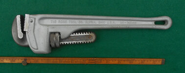

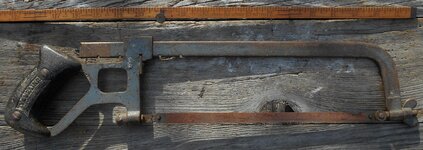

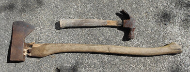

I've held off on using "Evaporust" as long as I can in an effort to preserve original finish and patina, but every now and then one has to make compromises.

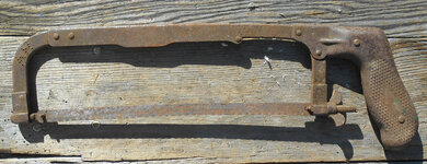

I rescued this from an open shed located about four miles from the Pacific Ocean:
12 inch steel hacksaw frame. No makers mark. Lots of owner marks.
On the flip side, we can see that "A.H." definitely prized this one, evidenced by the repair job on the outer end of the frame.
Into the pot it went
the next day it looked a little better
even better after a few minutes on a fine wire wheel

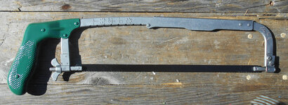

I gussied it up a bit - hopefully to protect it from the elements. As I had found little traces of green paint, that seemed the appropriate choice for a color. A coat of clear acrylic Krylon will hopefully protect the frame.
It will be returned to its proper home Friday. ;)

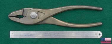

And here are the "after" photos:
Crescent Tool Co. (Jamestown NY) "MoToR KiT" 5-inch slip-joint pliers
These were pretty clean. I spent about 10 minutes on them with a brass brush and WD-40.
"Forged Steel USA" is the only mark on this pair of 6-inch Slip-Joints. I thought perhaps they might be Harrolds.
About 15 minutes with a brass brush and WD40.

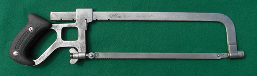

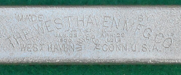

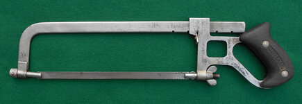

West Haven Mfg. Co. No. 12 'Easy Grip' Universal hacksaw (patent 641826 1060312) before and after.
Resorted to wire wheel after Evaporust. WD40 and brass brush just wasn't working. :(
  • West Haven Mfg. Co. No. 12 'Easy Grip' Universal hacksaw (patent  641826 1060312) 032525 01.jpg
