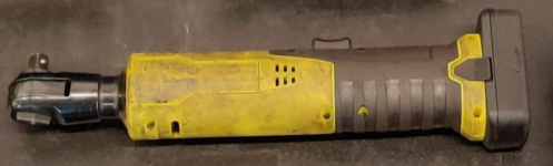

did a bit of searching and i couldnt find anything so i figured i'd start a new topic.
does anyone have any advice on cleaning the surfaces of power tools? i've been given the curse of really liking the high-vis color, so my primary power tools (ratchet, 3/8 impact) are high-vis. unfortunately, this presents as the problem of "they get really dirty really fast".
i've tried using brake cleaner but it also ends up wiping off lettering and writing. looking for something a little bit less aggressive but still strong enough to deal with brake dust, grease stains, etc.
pic for attention, my dirty-*** snap-on ratchet.

This is one of the reasons why I sometimes prefer metal bodied air tools to cordless - much more durable, and easy to clean!
Best option is a bit of WD-40, or similar, on a rag. It will cut through dirt and grease relatively easily.
You will get a bit of a thin oily deposit - leave it on the metal parts, but if it bothers you on the plastic use a trace of spirit on a clean rag to fully clean them.

Another method is to spray a microfiber towel with rubbing alcohol and then use that wet microfiber towel to scrub down the tool. You'd be surprised by how well that works.

I use Simple Green when I need to clean power tools, spray away from the vents, wipe with a blue towel, use the wetted blue towel closer to the vents. Mine dont usually get super greasy tho.

A spray on "orange" cleaner
No !
Some “Orange Cleaners” will melt plastic and rubber.
The first thing you should figure out is what type of plastic and rubber were used to make the tool.
Glass reinforced nylon is fairly common, and pretty durable.
Polycarbonate and ABS are occasionally used as well. (I think Makita uses Polycarbonate for dome tools, and ABS is commonly used by German manufacturers for some items)
The rubberized sections are another issue.
You best bet is to go from milder to mire extreme chemicals till you find one that works.
I’ve used dishwashing detergent, and Bronner’s liquid Castile soap on occasion, and neither is likely to harm the plastic and rubber.
Use a cheap toothbrush.
If that option doesn’t work, try rubbing alcohol, or naphtha lighter fluid.
The cleaner may need to be varied depending on what the gunk you are trying to remove is.

Mr Clean, the yellow all purpose cleaner works really well. Or a rinseless car wash soap if you have one handy.

GoJo will make it look new. Rub it on with a toothbrush and wipe off with microfiber.
i bought a old like 76 year ridgid 300 pipe threader, it was bad, ugly and black, a tub of gojo and it look brand new in about twelve minutes
