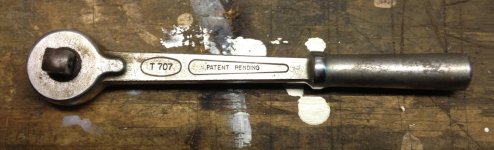

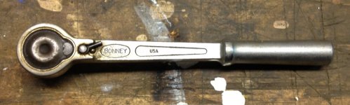

Just picked up this Bonney T707 ratchet this weekend for a buck at a garage sale. It's a nice little ratchet but it only loosens, it doesn't tighten. Feels like there's a lot of gunk inside it.
I can't see any way to open it and no oil hole. Anyone have any idea how to refurb this guy? I'd like to put it to use.

It looks like the seam around the workings on the outside of the head is a retainer that holds the guts in. I suspect that the retainer was pressed into place at the factory and may not be removable without damaging the guts. That would explain why there are so few around - buyer resistance to a non-servicable tool and those who tried to get them apart ruined them.
P.S. You might try to soak it with brake cleaner and hose it out with the nozzle of the brake cleaner after a long soak. That could remove the gunk. Then soak it in light oil for lubrication.

Squirt some atf in the head and starting ratcheting in the way it does work and the old gunk should start coming out. I have done this trick to a old sealed indestro and it worked like a charm.

Simple. Soak it in a jar of ATF, Remove it periodically, put a deep socket on it, then work it in both directions, Repeat as necessary.

Sounds like ATF is the stuff. Found some old Redline ATF in the garage and the ratchet is soaking in it as we speak. I'll report back later if it works.

Well, the ATF is definitely pulling some dirt and gunk out of the ratchet but I think the action is actually getting worse. Now it's slipping in both directions! I guess I know why the guy had it mixed in with his old junk wrenches, eh?
If anyone has any other advice on how to resurrect this old guy I'm all ears. Otherwise it goes on the display shelf.

Oh no. I have that exact same ratchet, and it is my absolute favorite. I've never found a smoother ratchet.
If the ATF isn't thin enough to wash it out completely, I'd go for something thinner.
If it were me, I would use mineral spirits or kerosene, and put it in an ultrasonic cleaner. That'll get all the gunk out of the inside, and after sufficient time to try, I'd add back some nice and thin oil.
