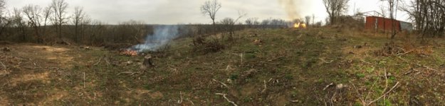

It has rained a little, and more rain promised for today. This morning there was a stiff south wind so I called the fire department and told them I was going to burn. If they had advised against it, I would not have, but the main reason to call is so they can stay calm when willy nilly calls in my brush pile.:willy_nil
West of the shop we cleared about three acres a couple of years ago. Bob piled it up for me, about 30 ft by 75 ft pile.
So I lit it off with a little used motor oil.
Wind is my friend
Getting a good burn. Sometimes the leaves burn off and most of the wood is left. The wind made it hot today.
I lit a couple more small piles in the same area. They did not burn well, but here is a little panorama.
Down wind there is a power line. I was nervous but it was fine.
How was my carbon footprint today?:dunno:
