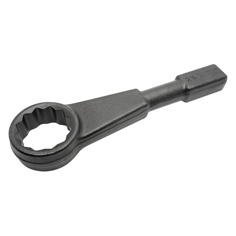

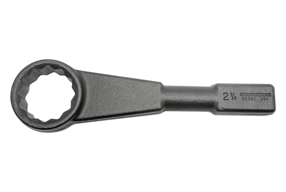

GearWrench® - 4-5/8" 12-point Black Oxide Straight Box End Striking Wrench​
0 reviews|0 Q&A|Item # mpn4695912097
GearWrench® - 4-5/8" 12-point Black Oxide Straight Box End Striking WrenchGearWrench® - 4-5/8" 12-point Black Oxide Straight Box End Striking Wrench
GearWrench® - 4-5/8" 12-point Black Oxide Straight Box End Striking WrenchGearWrench® - CatalogMade In USAGearWrench Authorized Dealer
$809.52
