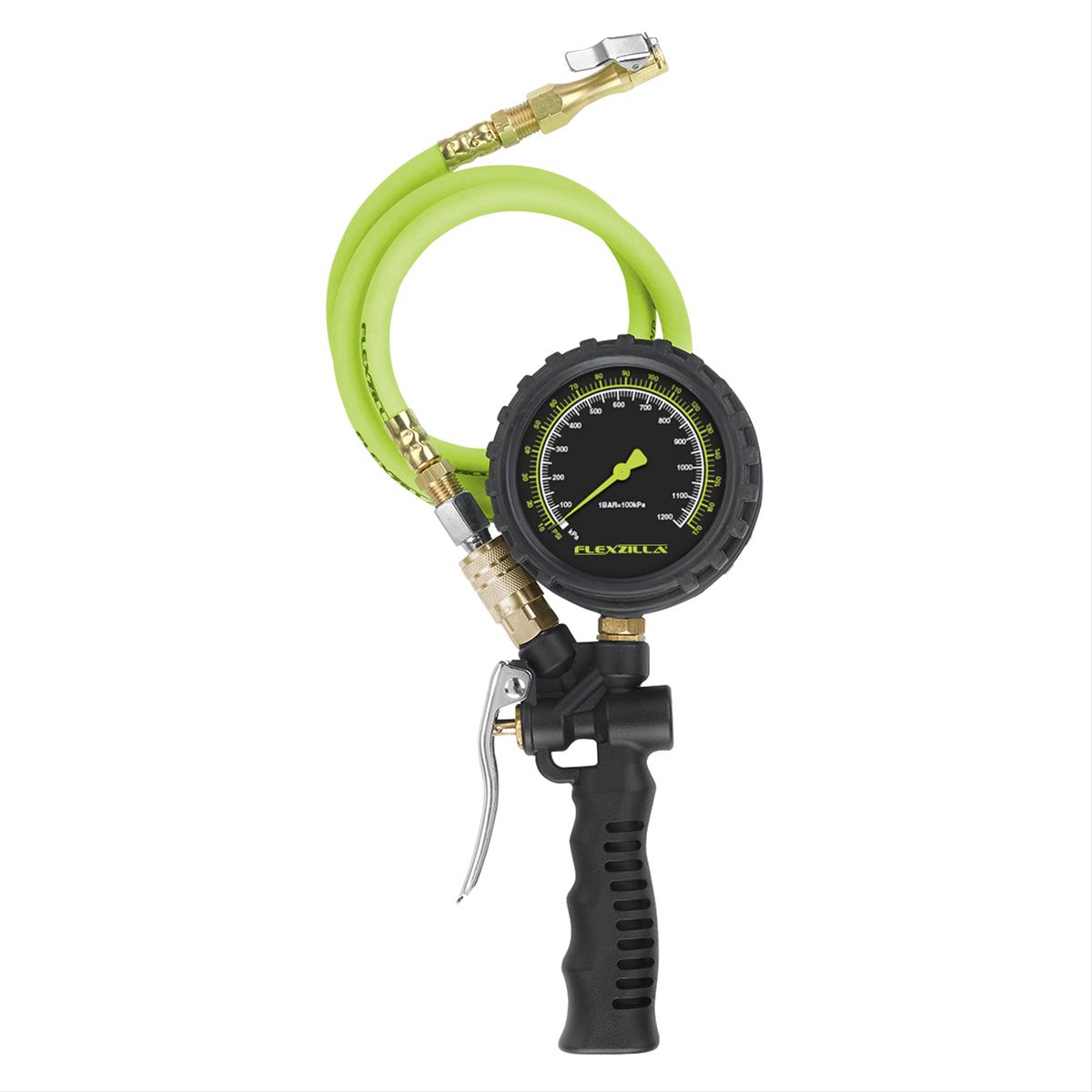

I have that Milton with a 36” hose, makes it nicer to stand instead of squat, and I just installed the inline locking head on it. Works great.

I bought this one from Amazon because of the big dial gauge and bleeder for mounting race car tires. Looked for a Milton or similar but couldn't find one laid out the way I wanted it.
The hose and chuck that came with it were kind of junk, but that didn't really matter to me. I put an 8ft hose and (IIRC) Dixon straight clip-on chuck on it. It's been great.
