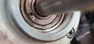

I now noticed today the seal on the vane pump was leaking when the table was turning under pressure (getting the first section of bead over the rim) - verified with soapy water and lots bubbles .. I slackened off the pulley, popped off the belt, removed the small v-pulley via the allen screw, popped in a tapping screw and managed to pull the seal out in place. Ordered a new one but im not sure if the original seal was high pressure so looking into it.
fwiw the seal size for the coats 5030 is .250 .500 and 1.375 bore (seal is 1.379).
fwiw this nationa/timken seal fits the size - not sure about the pressure.. ordered 2 so will see. The bearing in the back is a 6201..
Thats me dinging up the bearing seal! looks like it shd hold for now but i do have a drawer full- dont wanna pull pump out right now.. shd be ok-
