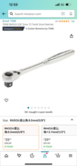

nothing much in the garage yet, as I’ve been helping others and waiting on parts. But, I had to show off the new ratchet.
It’s so little!!
I bought it just for doing the spark plugs on the Subaru since there’s low clearance between the engine and the frame.
This is the Amazon ad for it,
I might have to use it more than just the spark plug to see if I like it.
