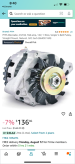

So I stopped once I had that info and I was thinking about the alternator. I did some digging into my old paperwork for the camaro and found it. Apparently I bought a 63amp alternator back in the day, 🤦🏻‍♂️🤦🏻‍♂️. I’m sure my fans are drawing half that just by its self.
Now I have a new CS130 alternator with a 160amp output coming in the mail. This is the alternator but I ordered it through summit after I found they sold the alternator. Makes me feel alittle better ordering it from summit instead of Amazon.

That alternator should do the job. Do you have a good heavy gauge ground and feed wire leading away from the alternator?

Yep, i put a 6ga wire on the power side when i installed the wiring harness to the 175amp fuse thats behind the passengerside fender. Now Im glad that was done. The ground wire is a 0/1ga from the block to the battery, some thick wire for sure but didn't want any issues and I had it on hand.

The new alternator came in, ordered at 10:27pm yesterday and was delivered at 1:05pm today, for free. That’s summit shipping when the part is available at their Ohio store.
Got it installed and it was charging with no issue and no drop major drop in voltage when the fan kicked on! No fan at 1,300rpm during fast idle it was reading 14.65v and when fan kicked on it dropped to 13.8v and was climbing back up.

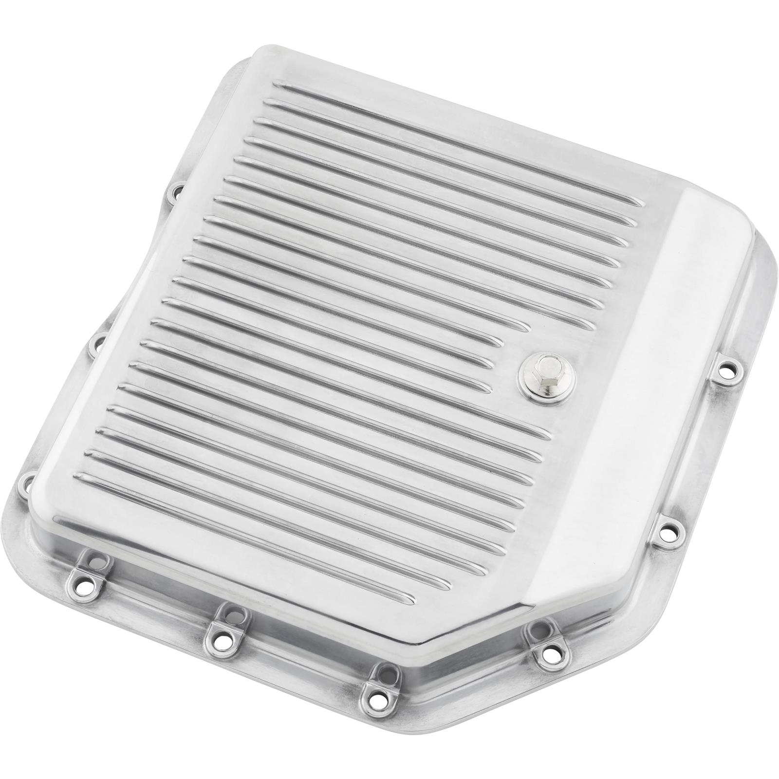

It seems the transmission pan is still leaking after checking the bolts to ensure none of them were loose. I’m thinking the steel pan might be warped and that thin gasket just can’t compensate for the warp in the pan. I’ll go ahead and order a cork gasket, or maybe a rubber gasket?
Cody, I end up buying finned aluminum pans rather than fighting with the stamped steel ones. Speedway (and Amazon) sell a polished cast one for $60 and Jegs sells a fabricated aluminum one for $50. You've already put a ton of time and money into the car so eliminating a potential never-ending problem might be worth it.
Well I saw your post last night and it did cross my mind. I went ahead and ordered the new aluminum fin pan. It should be in this weekend.

So I pulled the new shiny transmission pan out of the box. Nice and thick.
I got a cork gasket so I’ll just put the rubber one on the shelf to be thrown away in the future I’m sure.
Pulled the drain plug on the transmission pan so it can drip empty to be removed tomorrow.
I plan to reuse the fluid so I used a clean pan to catch the fluid. I got a jug of transmission fluid that’s 3/4 empty so I’ll use it to put the fluid in and pour it back into the transmission when I get the new pan installed.

Late start today as I was fighting a sinus headache this morning. But I got the transmission pans swapped.
The lube locker gasket was very thin, almost like a sheet of paper so I forfeited on reusing it and went with the cork gasket. I also torqued the bolts to 11 ft/lbs cause manual said to do 12 and I am concerned about the threads as I’ve already repaired 2 of them due to stripped threads. I also had to us a longer bolt for the shifter bracket due to the bolts provided was only 3/8” exposed without anything on it. But so far no leaks are seen and I’ll wait til tomorrow to call it good. I did crank the camaro up and let it warmed up some while checking the fluid level. Seems to be full.
