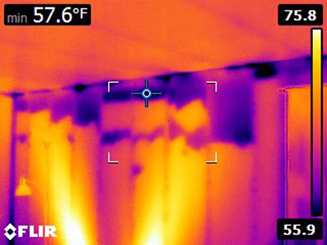

Now is the perfect time to get a hold of an infrared camera and do a thorough evaluation. Best results are achieved if done late in the evening or early in the morning before the sun hits the siding. Naturally, if you do this, make sure you download them to your PC and post them here. My bedrooms over my garage are cold too, but at least I know why = the old post construction blown-in insulation done by a previous owner has either settled or was never filled to begin with. The bright yellow and white are from the forced hot air vent in the floor.
Picture taken today 2/15/2015 @ 8:00pm. Outside temp = 8°F
