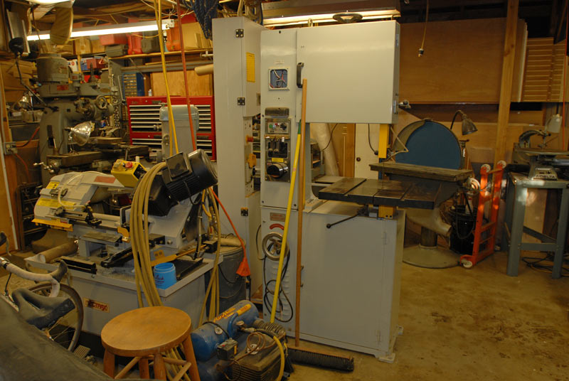

The type of work you do is going to dictate the best answer. I personally have used only a 4x6 horizontal (Taiwan Delta) for 30 years. It is very versatile but changing blades and speeds is something that should be done often. I tend to alternate between thin tubes (around 0.40” wall) and 3” solid 6061 bars. I also cut a lot of higher carbon steels with it. I got a vertical bandsaw recently because doing sheet goods on the 4x6 is not so great due to the limited capacity. A Swag stand and a deep cut portaband would be worse from the capacity view point. We use a type of cold saw for aluminum which is a modified miter saw with a blade which cost more than the saw. For long stock only it is fast and convenient. The 4x6 can be jigged to cut lots of odd sized and shaped stuff where the cold saw would be poor to unusable.
First flush, get a 4x6 saw and some good Starrett or Lenox bi-metal blades. All around the variable tooth 10-14 is good. For thick stock I usually have something like a 4 to 6 tpi around and an 18 tpi for thin stuff.
With 1/2” blades (all I think you can use in those type saws) the cut radius is pretty huge. The vertical saw I have allows use of 1/4” wide blades for way tighter radius or contour cutting.
With a belt sander, drill press and a 4x6 saw its amazing what can be done!
