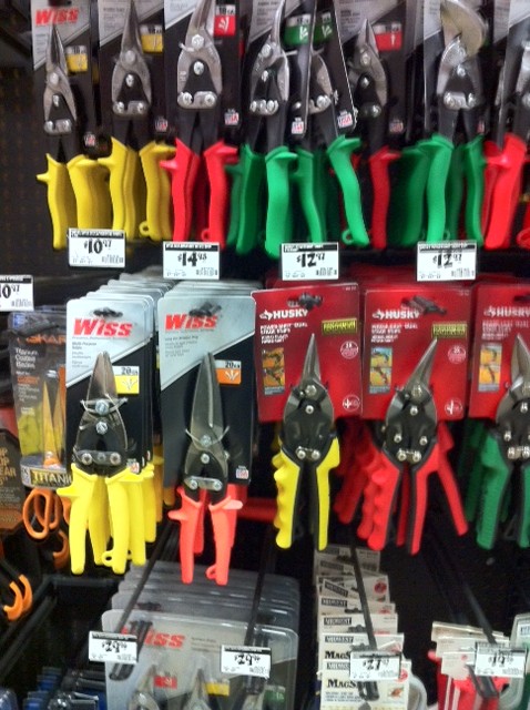

Can someone explain if there's any kind of consistent coding to the coloring of the handles of shears?
I had thought that one color was straight, one was left, one was right.
I'm pretty sure I've got a pair of BLUE handled Wiss right-hand shears, but cruising Home Depot last night, it appears blue has changed to green?
So, is this how it is now?
Yellow = Straight
Red = Left-hand
Green (was blue) = Right-hand
Anything else that I'm missing?

I used to think this to be true but then ended up with a red handled pair of straight cutting snips.
Mine are Wiss by the way if that makes any difference. Maybe different brands use different color codes?

I had a set of blue handle wiss snips years ago, they are for cutting stainless steel & other harder metals. Google shows red #M1R, green #M2R & blue #M1RS1 & M2RS1.
reds & greens are most common. yellows are straights, but I use my large Andy's instead.
I normally only use the reds & greens for sheetmetal work, years ago I found a set of blues, I figured they would last longer on just sheetmetal......wrong, someone I worked with used them to cut strapping wire.....junked them!

I think the color coding is a newer thing. My older snips have blue or black handles (I remember some being red).
Lately everything I see (not just Wiss) is yellow=straight, green=right, red=left.

If by a "newer thing" You mean since Wiss started putting the plastic handle on their Aviation snips (Over thirty years ago), then you right... Other brands :dunno:
Std
M1 - Red = left
M2 - Green = right
M3 - Yellow = straight
M6 Red offset = Left
M7 - Green offset = Right
Special
M1/M2/M3 - Blue L/R/S for Stainless Steel
M5 - Red = Straight mini Bulldogs. (For heavier material - Pre SS Blue, but still sold I think)
Yellow Double cuts = Straight
