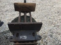

Hello
I need some advice.
I posted this vise first as a find on the Garage Sale thread. I also posted some of these issues I ran into along the way with the restore. I will re post the important information from the Garage Sale here as this was recommended for a place people could more easily find if they have the same vise or questions/issues. I am not out of the woods yet and I do appreciate all the help I get along the way. Thank you!
Bought for $45; local pickup.
The Metal separator plate and Static Jaw slid right off after I removed the cotter bin in the back.
Had to go a little crazy to get the bolt off the slide rod. This was after it was sprayed with PB blaster, sat overnight and sprayed again.
Sadly, I realized I damaged the thread. I thought the Nut was tight from rust. However, now I know, the end of the bolt threads had been hammered so the bolt would never come off. I broke the outside thread taking the bolt off. This picture taken after I cleaned up the slide rod with a wire wheel.
Another finding. The outside slide rod thread is more proud (taller) than the rest of the threads. Was this the result from mushrooming the end? Not sure.
I decided NOT to remove the other slide rod. I can see it is hammered as well. I wire wheeled it, the main screw, and the handle all attached. Heavy and hard. Harbor Freight drill wheels were really scratching up the surface of the slide rods. Dewalt(bench grinder) and Forney(drill) wire wheels removed rust and did not leave scratches.
I have NOT been able to get the Nut back on the slide rod. The threads look pretty good(no cross threading) on both the nut and bolt but no go. I put the slide rod in the soft pole jaws on my vise and it spins in the vise before the nut will move. Nut move about 1/2 turn then stops. I filed down the "proud thread" some and I think that did help but still getting stuck. I do not think i filed it level with the other threads yet. Not sure how important it is to file the top only vs the sides too.
I went to Home Depot today and bought a 3/4 Coarse Nut and Bolt. The vise nut gets stuck on the HD bolt. The vise slide rod gets stuck on the HD Nut. Ugh. Was expecting only one to have an issue, not both.
If you have any advice how to resolve my current issue as I go through this process please let me know. Thank you!
Questions:
1. What grit sandpaper will I need to go up to so I do not see scratches on the metal any bigger than the factory finish? Max I have now is 220. I have 400 on order.
2. How would you fix my thread issue? I have been advised just to crank it on. Now that I have a 3/4 coarse bolt I can clamp that and crank the nut on it. That might fix the nut.
3. How would you hold the slide rod without damaging it? I gashed it up with the pipe wrench I used to loosen the slide rod bolt. Thus the reason for question 1....
I'll keep updating this thread during the process of restore and workbench mount. I have to add a couple 2x4s under the bench to mount this.

I have had success with repairing a damaged thread like that using a three-corner file, carefully working the oversize area down to the same pitch diameter (technical term) so the threads are uniform in diameter with the undamaged threads.
If you can find something with the same thread (pitch and diameter) to try the nut on, you can determine if the internal threads of the nut are damaged. If they are OK, or if you have the appropriate thread restorer, the nut can be your test gauge for your work on the male threads. Go slowly and check often. You can use Prussian Blue or a Sharpie to find the high spots.
Provincial
Sep 21, 2011
6,874
Near Salem, OR
If you can get access to a thread pitch gauge, check the pitch of the threads and compare it to the HD bolt and nut. The vise may not have standard threads!
If the threads are standard, try to find someone with the proper thread restorer male and female tools.
ClappedOutBport
Mar 30, 2016
998
That peened thread is still too big. You need to remove it, until the crest is no longer proud. You might be able to get away with just grinding the crest off, but I'd grind it all the way down, and keeping going until it cleans up.
Shiftless
Mar 9, 2014
14,606
East Bay SFO
That’s the way it looks from here too. :+1: to that ^^^^^^^^^^^^^
Hopefully you know someone who has a tap and a die of that size to help clean up those threads.
They’d be pretty expensive to buy new, especially for a likely one time use.
The die you need to clean up the threads on that rod will look something like this one of mine. You don’t need a specialized handle...just use an 1 1/2 inch wrench or if you don’t have one of those, a big adjustable “crescent” wrench will do.
But like C.O.B. said, you’ll probably be in good enough shape if you just grind that buggered thread down slightly below the level of the other threads. It looks like the rest of the threads are clean and the nut will have enough to grab.
How would you lock the nut back on though? No more extra metal to peen over. Maybe blue locktite would be good enough. Red locktite will definitely hold it.
If your nut is buggered up too, that will need a tap.

You're overthinking this. It's the outside thread, you've got plenty holding it. Just make it go away. Sitting on the grinder rest just slowly roll it along the thread. Like I said, no harm in taking it all the way to the root diameter. That's what I'd do. Won't look as pretty, but it's too late for that now.
Just grab a new nut if the old one is trashed. They just used a standard, off the shelf nut, no reason to worry about a 100% restoration.
Yes, they need to be tight. That's what keeps the jaw from rocking back and forth and damaging the shaft. That's why they peened it, so the nut would never back off and stay tight.

I've definitely put alot of thought in. I was going for the 100% restore so a bummer when I found out the bolts were hammered and some machining would be required to get it all apart and back together.
For some reason last night I was just thinking hand grinder and that's what my comments were about. I agree bench grinder makes ALOT more sense.
I already picked up a new nut and it gets stuck too. But after i bring that outside thread down both old and new nuts might be fine. We shall see!
What would you take out the proud marks I left in the sliding rod with(from the pipe wrench)? Will working up to 400 grit get back to the factory look on the slide?

Nope. Sandpaper isn't very judicious in it's removal of metal. As much as it takes off the highs, it will take off the lows. A file works excellent. With some technique you can remove the burrs without touching the base metal. Afterwords if it needs a little polishing then use some sandpaper, but sparingly.

Like he said, I’d start by filing and then if you want to achieve a super smooth and nice brushed steel finish, keeping the rod perfectly round you can try this technique. Soak wet or dry sandpaper with WD40 or ATF or other light oil, and use some spark plug wire or vacuum hose and work it back and forth.
Realize that those parts will not be visible when the vise is actually installed.

I think you could start with something like 320 or 400.
If you want to experiment with polishing just for the experience, you could then move to 600 and then to 1000 grit.
Don’t be tempted to go cheap with garnet paper. Use wet/dry or even emery cloth if you want the most durable.
For polishing parts of vise handles etc., I cut strips of 600 grit and use this shoe shine technique.

Scotchbrite (maroon then grey) also does an excellent job at leaving a scratch-free luster. Shiftless is right, cheap emery doesn't pay.

I hit a few sales on Friday and today was mostly family day; both great joys. I did manage to get some updated pictures of my Columbian Vise. I don't think any new work since I last reported but definitely clean parts that haven't been seen :)
Note:
What holds the dog piece in place is a pressure fit, not a threaded screw.
Take Notice! The Nut is on the Slide Rod easily by hand!!!
Next Steps.....
1. Fix my pipe wrench peaks (file)
2. Final wire wheel where needed(flash rust) and get paste wax on the shiny parts quick.
3. Complete any "unsure parts" below
4. Paint with Boiled Linseed Oil and either bake dry or let dry naturally. Does BLO dry harder if heat is applied? Not sure...... Is it OK for the still attached slide rod and main screw to bake at 400 degrees for 4 hours? Not sure....
Unsure parts....
1. The easiest part to remove next would be the handle and main screw. I would grind the peened end and tap out the pin holding it together.
2. If I want to remove the other rod I would grind the outer thread, then should not have thread issues. But would also need to solution the current rod turning issue. Options are: Drill a hole at the end(use punch/screwdriver to hold). Grind flat top and bottom at the end(use wrench to hold). Use pipe wrench at the end.

Next Steps.....
Right..file first them smooth with sandpaper strips
Yes, paste wax is good. I also use Fluid Film for that kind of thing. It’s a lanolin based rust barrier that is also a good lubricant. But realize that if you’re using that vise, that oil attracts sawdust and wax doesn’t.
I’ve never baked BLO so I can’t say. Don’t paint it on heavily without rubbing off the excess with a rag or paper towel. Multiple thin coats are way better than one thick coat.
I can’t imagine how that would damage steel. Just don’t do something crazy like quench hot cast iron with cold water.
B
b.well
May 13, 2020
391
NY
Next Steps.....
a. YES
a. Didn't realize that about Fludi Film. Thanks for this tip. This will be next to my mitre saw so I'll go with the wax.
a. I'll have to find the video again where the guy baked it. I use BLO on wood handles and do exactly what you said. Multiple thin coats wiping off the access. Have not thought of it the same way for metal. It won't soak in like wood. Still I get that multiple thin coats are better, same with most paint I think. How long would I wait between coats? Overnight? Or just a few hours?
I can’t imagine how that would damage steel. Just don’t do something crazy like quench hot cast iron with cold water.[/QUOTE]
a. Thanks for the confirmation!
