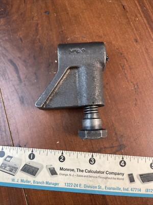

I have a date unknown Columbian vise with a bad main nut. I have about 3/4 of a turn of backlash. I was initially excited when I decided to take it apart and drifted out the main nut, and then not as excited to struggle to find the part or find similar vise nuts that run for over 200 dollars.
I learned that Wilton owns the Columbian tool company. I did shoot their parts department an email.
I like the medium duty vise for my garage, but I picked the thing up for $40, and spending more than that is too much. I would rather save up for a new-to-me vise. I would love to find a replacement nut, I think it is hard cast lead, but if I can't I would also be happy to pass along the parts I now have.
I don't know if the swivel base would work on a another vise. The jaws are in decent shape as well.

Nut Markings:
25
D4X
In Short: I am looking for a new Columbian D44 Vise Nut. If I can't find one, I will have D44 vise parts (minus the nut) to give away.

The nut has almost razor thin threads left in it. It still works, but there is not a lot of life left. I would bet that one really strong tightening would pull the threads right out.

I threaded a 16 AWG copper wire into the nut and that certainly tightened things up. I don't know how tight these vises where brand new, but it is much better than before.
I would still be interested in a replacement part if possible.

Find somebody with a home machine shop. They could either make you a new nut or bore that one out and sleeve it with brass.

Exactly, not a really hard item to make. Perhaps get an Acme hex nut and fit it to the original machined nut or to a newly machined base.

I would look in Mcmaster carr or Roton and see if you can find a steel Acme nut which fits the OD and thread pitch. Weld to an equivalent steel base that matches the cast original closely.
Tapping/internal threading Acme isn't trivial....one can single point them on the lathe but you are asking a lot of the tool/needs a heavy boring bar and a lathe with the mass to hold it. Ideal would be to thread mill on CNC but the $200 repair part starts looking pretty good quickly.
Imo the copper wire takes up the backlash but does not do much for the low strength sharp-pitched Acme threads...also its going to get crushed quickly if the vise is tightened up smartly.
