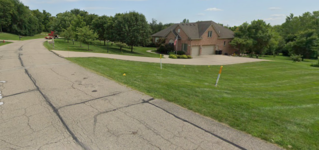

Friends of mine have what looks like a ranch house with a 3-car garage on the side.
House is a bit lower than the road and looks like this:
It's not obvious from the street, but if you continue down, past the garage, the driveway circles back to the other end of the house, where there is a HUGE garage that holds the 40' Class A motorhome and a 7x14' trailer to haul the motorcycle.
Yeah, it's all custom-built, and a very entertainment-friendly layout.
