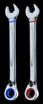

Reversible ratcheting,15 offset,anti slip open end;
I beam handle for more touch.
Blue for metric,Red for SAE.(Is it neccessory to make this color for identify metric and sae?);
The blue and red color is " Nano Anhydrous Plating",which is environmental friendly than normal electroplate;
Chrome finish or satin?
What is your idea about this set?

You claimed you were promoting your product and yet you keep copying and pasting this same post over and over....
bryant 24
May 17, 2023
127
First,this is not an product ,its just a concept,why i post over and over,because i am not sure if these function combined together would be resonable,my initial purpose was to discuss this concept with you,rather than send a link and promote it.
For example,i want to know if color coded for the ratchet is resonable?
Offset with reverse?
Satin or chrome?
Thank you a lot for understand.

Color coding is okay but not something I need. Other people may like it or even find it helpful.
Offset w/reverse is usually best and I have examples of all these styles.
I prefer satin but I have all three colors.
