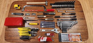

As a DIYer and general fixer favour guy for friends and family, I usually have a general hand tools toolbox in the car, as I'm likely to need it for one thing or another. It's a compact aluminium case style, weighs 13kg (of which 2kg is the box itself), and fits out of the way in the passenger footwell or behind one of the rear seats. So there's always a spot for it regardless of whether I have a few passengers, luggage, or a bike etc. It's absolutely packed out full (13 litres internal), and despite some general areas (no dividers) for different types/shapes of tools, it's mostly a pile of tools that has to be unpicked and repacked.
I'm interested in improving that, while maintaining compactness. Quite open minded, and appreciate that many things are tradeoffs. I've been through many threads on here (lots of good links from this post) but would like some thoughts for my specific needs.
Contents - hammer, fixed and adjustable wrenches, various pliers, socket set (not in own box), screwdrivers, keys, bits and driver, measurement and marking things, cutters and knives, junior hacksaw, multimeter, ...those sorts of things.
Cantilever toolboxes... good access and organisation, but likely to damage my interior.
Tool bags... unstructured ones have no organisation, structured ones are pouch/pocket per tool which seems inefficient.
Tool rolls... likely to be on the small side and space-inefficient. Never thought of it until I saw this Pangolin. I would however like to be able to just open the box and grab something rather quickly, without unrolling and opening pencil case zips etc.
Plastic standard toolboxes... no organisation apart from a tote tray that lies on the top inside.
Plastic Pelican-type cases... the shape works but lack of organisation in most options, often people do foam (I won't), or get tool cards/pallets with elastics on them. There is the Keter 221474 which is just a little bit too long.
Plastic system/stack toolboxes... there's a lot of innovation and competition in this space, but most of the options are very large, heavy (almost 5kg), and space inefficient (50-60% internal volume for the external) due to the interlocking mechanisms and rugged design. The case type (e.g. standard Packout box) opens on the biggest side, giving you a lot of access, however they're too long (>50cm) to fit anywhere I want to put them. The ammo box type (e.g. compact Packout box) might suit; it has good flexible internal organisation, good shape, weighs 3kg, quite efficient (66%; 22 litres inside), and could lock a parts organiser underneath. There's also the various L-BOXX brands for which various internal organisation accessories are available, but the shape/size combos don't suit (that goes for Metabox/Systainer too).
What would you go for? Box/bag/brand etc. I'm in the UK but feel free to share any international options for our general interest.

IMHO, The handiest all around Tool Box i recall owning was a Kennedy Kit, cantilevered tool box i bought used in the late 1950's. I paid $10 for it, the seller probably had stolen it from the Air Force.
That box held all my tools, except for my hand saw. I didn't own any power tools until 1970. That box served me well until i stupidly left it behind when i moved. It was replaced in 1969 by a Waterloo Chest, if i remember correctly

I have this one.
Pretty sure Waterloo made these for a lot of others.
I have two in a slightly different version, one branded Snap-On, the other by the maker, Waterloo.
Long discontinued. "sit, stand, tote" they were called. Sears Craftsman offered one with a wheeled caddy.
They are big and can be loaded with a LOT, one of mine is near 100#.

I have one of these branded from Snap On. FANTASTIC box. I use it for my leads and accessories for my Miller Maxstar when I'm on the road.

IMO the problem with tool boxes for something you travel with is that they are not deformable, and always take up more room than needed no matter how full or empty they are.
I travel extensively for work, and over the years have tried just about every option for how to transport tools in a way that is light and compact while still being organized and easy to work out of when needed.
My solution is a soft-sided tool bag, something like this but with the rigid insert removed: https://www.amazon.com/Rothco-G-I-Style-Mechanics-Tool/dp/B000BFNJEI?tag=atomicindus08-20
Inside of that I pack my tools in clear zipper bags organized by function/size etc: https://www.amazon.com/SUNEE-Multis...rganizing/dp/B07RGHT11D/?tag=atomicindus08-20
Bigger items like multimeters just go in the outer bag loose.
This gives me a useful lightweight pack that only takes up slightly more space than the tools inside of it, and when I use the tools I just pull the bags out and the transparent sides make it very easy to find everything when needed.

I have just about anything for most repairs in these tool rolls and bags. If I can’t fix it with these tools then I will just call AAA.
These are in my wife’s car.
Keeps it nice and clean in the back.

My USAG 646 has the same/similar feet on the bottom with a punched hole. I put stick on feet on them, one came off very soon after. USAG didn't respond to when I inquired about matching feet for them. It sits in the spare tire well, which is carpet lined, so no worry about scratches. Still, push in rubber feet or something would be nice.
