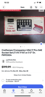

Wickedwardscustoms
Aug 1, 2022
1
seller said he bought these in the 70’s. Says on the box tab made in usa. You can tell a good solid 70’s tool just by looks
