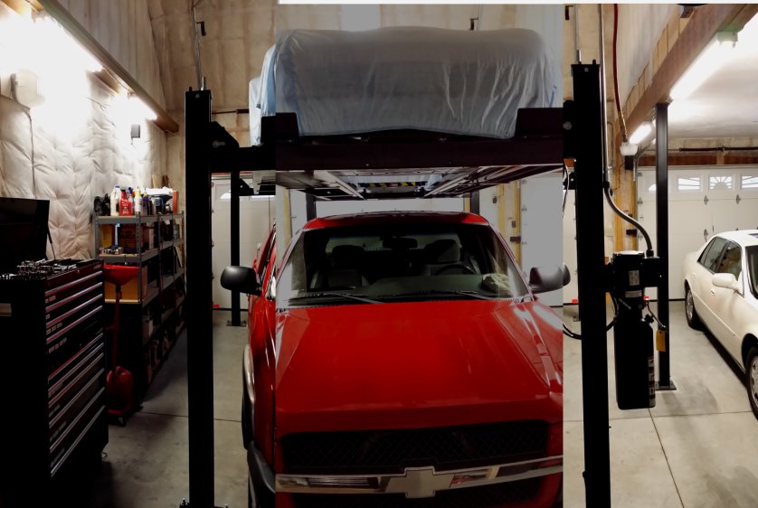

Chevy-SS
Feb 11, 2010
1,500
Rhode Island
Might as well get those lamps while they're still on sale. It's worth waiting for the lamps if they're not in stock at your location.
Thanks again. These lights work great. I put up two yesterday, and then two more today....... one at each corner of my 4-post lift. Now I have some light when I take off a wheel! :D
Here's a quick photo... it's multiple photos "stitched" so it may look a little out of perspective.
